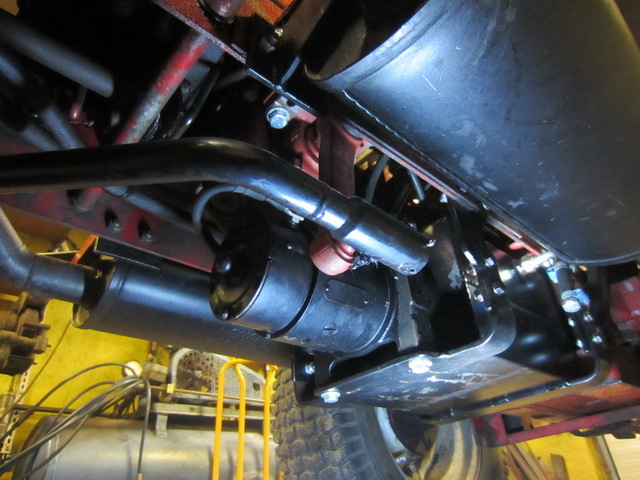

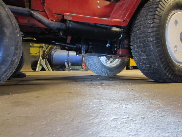

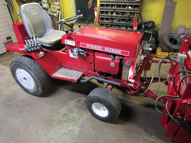

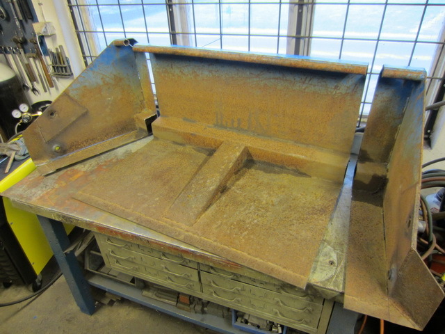

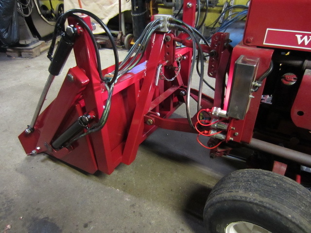

Swemill 66 #40 Posted December 23, 2013 Work in progress! Have replaced the sloppy steering box to a much stronger (and bigger..) Ross gear from a bigger Volvo BM tractor. Much work was needed to be able to get it into place... Cut down the housing and it's attachments, steering shaft, gear shaft, pivot arm, shorten and bend the drag link etc. but it now seems to work ok! In this picture you also see the hydraulic pump, tank and motor i've mounted under the tractor. Hope this also will work out ok... Bought an old front end loader but it were in pretty bad shape and also needed to be rebuilt. Cut down the frame and bucket to suit the wheel horse width better. 2 Share this post Link to post Share on other sites

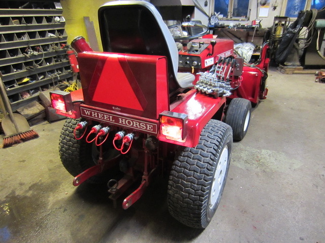

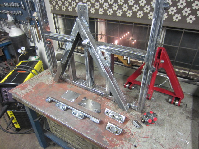

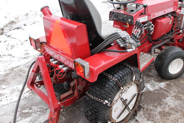

Swemill 66 #41 Posted December 23, 2013 Ok, it's not a "real" loader, but it lifts around 170cm (67 inches) and is very easy to connect on the A-frame i built earlier. With the same A-frames at both front and rear hitch i could easy use it at both ends and also use my counterweight. My plan is to build a new weight that allows me to also connect my trailer. Could be useful to be able to take along if there is some snow that needs to be removed! Hydraulic connections at both front and back. With the "switch"-valve, the 4 sections on the fender and the original 2's i now have 7 functions and have use for them all! The plan is to replace the toplinks to hydraulics and be able to tilt the A-frames. Have now some hydraulic hoses to do and will get back later with more info and maybe some video... =) Share this post Link to post Share on other sites
dodgemike 52 #42 Posted December 23, 2013 Outstanding fab and restomod Work. Love where you mounted Your valve body. My first two hot Rods years ago were Firebirds. I am a Mopar guy now. There is Room in the hobbies for all of us And our diversity. Sent from my SCH-S720C using Tapatalk 2 Share this post Link to post Share on other sites
Swemill 66 #43 Posted December 23, 2013 Thank you dodgemike for your kind words! I also like Mopars.... My dreamcar since i was a little kid has always been a Charger 68 - 69. Share this post Link to post Share on other sites

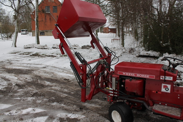

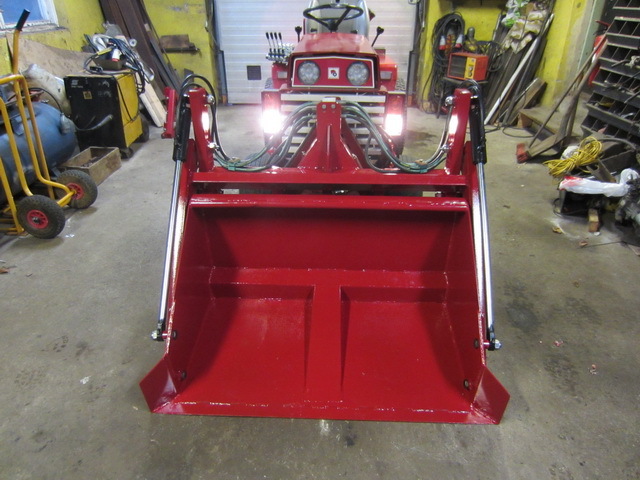

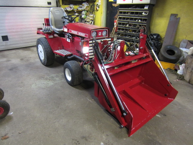

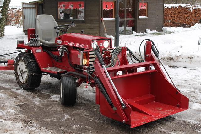

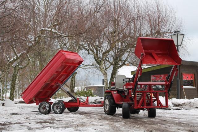

Swemill 66 #44 Posted January 19, 2014 Some new picture with the loader. What do you guys think about it? Have not used the loader much yet but the snowblade a lot more... 4 Share this post Link to post Share on other sites
JERSEYHAWG / Glenn 4,499 #45 Posted January 19, 2014 Swemill, real nice work, the fabrications look great. keep posting please. Now I have to find your you tubes and watch them. Glenn Share this post Link to post Share on other sites

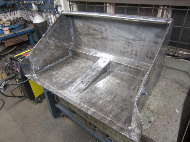

glgrumpy 35 #46 Posted January 19, 2014 Wow! You CAN fabricate! Never seen a loader like THAT one before! What was that orig off of? We in US have a "Jonny-bucket" kinda like that, yet won't raise that high. Must be a Euro thing? I really like that White grill, breaks the red up nice. Think I'll do mine white. You made nice gas tank. Those orig tanks are in dumb place, and take up room for seat to move back. Yours seems thinner and the taper allows seat back farther. I LIKE it! Most changes to tanks end up on a side fender, I don't like that. Sure lots of hydraulics on that rig now. Steering isn't best on these, big radius for sure. Hope that new set-up is tighter turning. Share this post Link to post Share on other sites
Swemill 66 #47 Posted January 19, 2014 Thank you very much! =) The loader is origin an early "Side Skopan" - a Sweden fabricated universal loader. Yes, it raise really high! Sure enough for this little tractor. http://www.sidesystem.se/?sideskopan,41 Yes, this gas tank is thinner and allows a better seat placement! The steering has unfortunately the same radius as earlier... Not easy to get it better because of the geometry and movement of the front axle. Share this post Link to post Share on other sites
