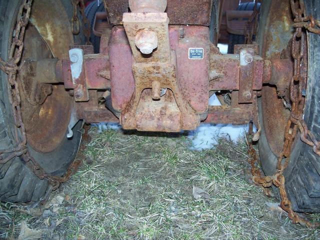

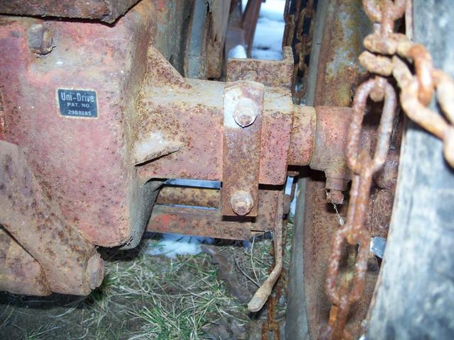

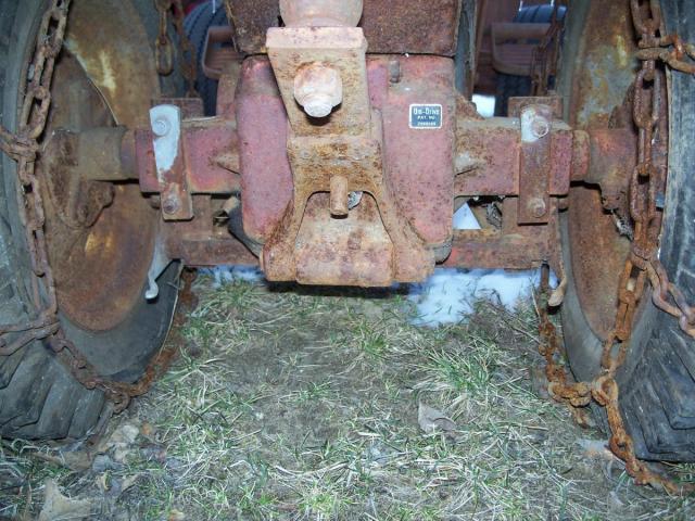

Kelly 1,036 #6 Posted March 15, 2013 The 855 uses the old style plow bracket, it bolts in front of the axle, not under it like the newer tractors, I can get pics this weekend if you need them. Share this post Link to post Share on other sites
chevyaddict83 39 #7 Posted March 15, 2013 That would be great! Thanks kelly! Share this post Link to post Share on other sites
Kelly 1,036 #8 Posted March 18, 2013 I had to find this tread again , these are not great pics tractor is a bit rusty, but it is a 655 pretty much same as your tractor, you can see the early mount goes in front of the axle, unlike the newer mount that goes under the axle. Share this post Link to post Share on other sites
