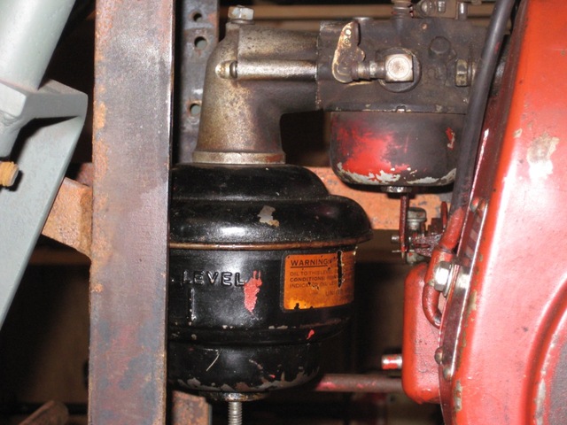

stevebo-(Moderator) 8,604 #7 Posted March 14, 2013 Here is one Share this post Link to post Share on other sites

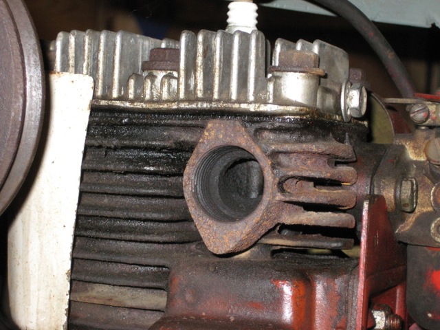

VinsRJ 723 #8 Posted March 14, 2013 Here's another one and the pic of the port. Share this post Link to post Share on other sites

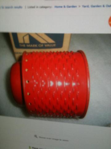

Lane Ranger 11,814 #19 Posted March 15, 2013 My brother has one 1959 RJ Wheel Horse that has a different air filter on it than the oil bath or front facing air filter on the carb of the K 91 motor. The attached photo is of a Kohler metal cannister air filter that contains the paper element. It is a drop down mount cannister . The paper element canot be replaced and you have to change the whole cannister when it is time to replace the filter. I have seen a quite a few RJ's at shows. Not sure if it was an original item on some Wheel Horse RJ's or came from other spec motors installed later on RJ's Looks nice on the tractor and operates well too.. Share this post Link to post Share on other sites
chris11 184 #20 Posted March 15, 2013 Im letting my son Drive the puller this year ill stay on the little one. Share this post Link to post Share on other sites
buckrancher 2,695 #21 Posted March 15, 2013 My brother has one 1959 RJ Wheel Horse that has a different air filter on it than the oil bath or front facing air filter on the carb of the K 91 motor. The attached photo is of a Kohler metal cannister air filter that contains the paper element. It is a drop down mount cannister . The paper element canot be replaced and you have to change the whole cannister when it is time to replace the filter. I have seen a quite a few RJ's at shows. Not sure if it was an original item on some Wheel Horse RJ's or came from other spec motors installed later on RJ's Looks nice on the tractor and operates well too.. that is the correct style for a RJ with a clinton engine except the louvers on the side are cut the wrong way that air filter is made to be mounted up the correct one's are cut to hang down(louvers on side are cut the other way) I have seen a RJ's with that style filter on a kohler but I think the owner did it not the factory. it's normaly the oil bath on the K90's or the standard round paper filter on the K91's Brian Share this post Link to post Share on other sites

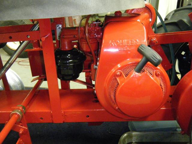

rydogg 186 #22 Posted March 15, 2013 Here is a k90 that I setup with a updraft oil bath from a Clinton engine they are a little smaller but easier to find. Share this post Link to post Share on other sites
WHRNaddict 5 #23 Posted March 17, 2013 That looks like the one setting on my work bench, only now it has the correct filter. I'll part with the under size filter if anyone has a need. Share this post Link to post Share on other sites
