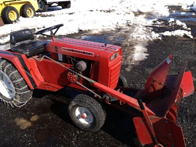

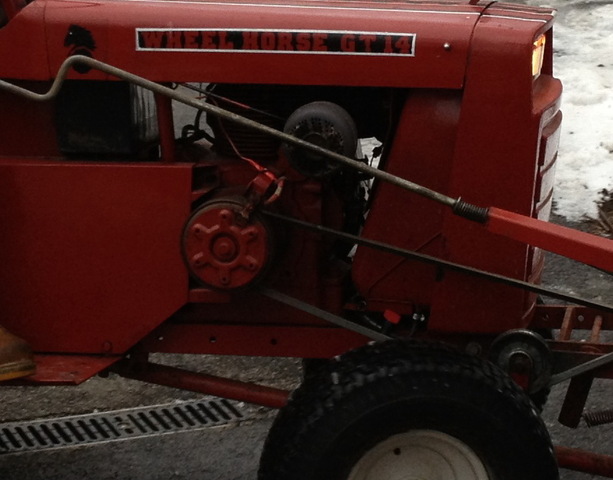

Machria 78 #1 Posted March 11, 2013 Ok, the snow is over, I think. I want to take off the snow blower from my new GT14. So I looked at it last night, how do I get the belt off the motor pulley? Do I have to take somethin apart? Thanks in advance! Share this post Link to post Share on other sites

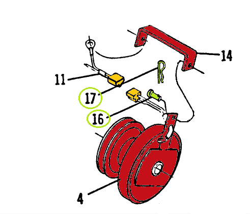

TT-(Moderator) 1,162 #4 Posted March 11, 2013 Unplug the connector on the clutch wiring. (orange) Remove the hitch pin clip (#17) from the clevis pin (#16)and remove the clevis pin from the clutch tab and the stop bracket. (#14) Rotate the clutch "face" in either direction to allow the belt to be removed. Rotating the thrower drive belt tensioner assembly against the tension of the spring should allow enough slack to remove the belt. Share this post Link to post Share on other sites
