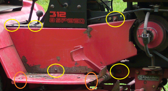

TT-(Moderator) 1,185 #4 Posted March 10, 2013 The drive belt guard comes off first. I have circled the belt guard fasteners in yellow (remove completely) and the footrest clamps (loosen) in orange: The tractor pictured above is a 1990 312-8 with a manual PTO clutch on a Magnum 12. That should be the only major difference between it and your 315-8. Once those two pieces are out of the way, the idler pulley will be visible. Remove the bolt securing the idler pulley to the clutch arm and remove the pulley. Do not bend the tab above the pulley to get the belt off. The lower belt guide on the engine can be loosened and dropped enough for the belt to clear. I believe the top bracket (bolted to the engine just above the drive pulley) for the rod that holds the PTO clutch may interfere with belt removal/installation. (sorry - can't remember) If you can't get the belt past the guide on the bracket, remove the bracket from the engine. Remove the belt from the tranz pulley first, then the engine pulley. Install new belt on engine pulley first, then tranz pulley, and reinstall idler pulley last. Depress clutch pedal to make installing the idler pulley easier. Once belt is installed and under tension, adjust the lower guide at the engine pulley so it is 1/8" away from the belt. 2 Share this post Link to post Share on other sites

TT-(Moderator) 1,185 #6 Posted March 10, 2013 Very similar procedure, Don. The hydro fan can be "worked around" without removal, but removing the right rear tire seems to make it a little easier. Share this post Link to post Share on other sites
