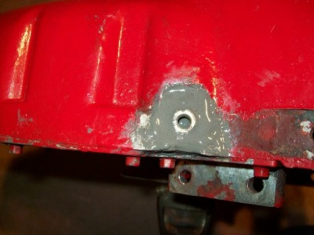

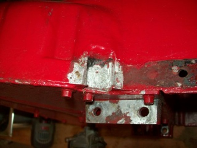

tzthompson 2 #1 Posted March 8, 2013 I am working on my 753 and would like to repair the places on the side where the hood bolts attach to the gas tank. The tapped portions are gone. Any ideas would be appreciated! Thanks Share this post Link to post Share on other sites

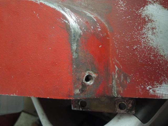

rmaynard 16,878 #2 Posted March 8, 2013 My 701 tank was repaired with Helicoils. Share this post Link to post Share on other sites
tzthompson 2 #3 Posted March 8, 2013 If the 701 tank is the same as a 702 tank, I can see where the heli coil would work. The 753 tank is a two piece type and the material where the hood bolt used to go is broken out. The PO had bolted a piece of metal strap to the side of the tank and tapped a hole to receive the hood bolt. Although it worked, I want to do away with the strap. Share this post Link to post Share on other sites
rmaynard 16,878 #4 Posted March 8, 2013 I'm not sure how different they are in the hood mounting area, but here is a picture of mine with a helicoil installed. Share this post Link to post Share on other sites
tzthompson 2 #5 Posted March 8, 2013 Would it be possible to fill the void on my tank with something like JB Weld and then drill the JB Weld and install a heli coil? Share this post Link to post Share on other sites
rydogg 186 #6 Posted March 8, 2013 I would try to JB weld in a nut that matches the hood thumb screw or you could tig weld in a new piece of aluminum and drill and tap threads. Share this post Link to post Share on other sites

buckrancher 2,695 #11 Posted March 9, 2013 (edited) welded a new piece of alum. in Edited March 9, 2013 by buckrancher Share this post Link to post Share on other sites
tzthompson 2 #12 Posted March 9, 2013 Well, I went with rydogg's suggestion since I don't have a tig welder. I epoxied two flat washers to the bottom of the nut so the hood bolt wouldn't bottom out against the gas tank. Then as you can see I used JB Weld to encase the nut and washers in the tank. Waiting now for it to cure so I can do some sanding. I guess time will tell if it will hold. Thanks! Share this post Link to post Share on other sites
welderman85 53 #13 Posted March 10, 2013 should work good nice repar Share this post Link to post Share on other sites
