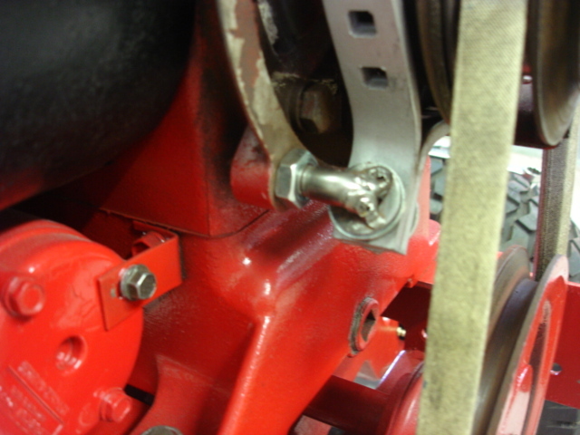

Marv 982 #1 Posted March 7, 2013 The Pivot point on my yoke is loose. The L shaped "bolt" That screws into the engine cover plate is loose in the cover. I am wondering if it is advisable to drill and Heilicoil the threads in the cover. What deo you all think? Marv Share this post Link to post Share on other sites
bewford 21 #2 Posted March 7, 2013 Don't see why it wouldn't work. Drill gently, and straight. One of my Ds has this tab broken off, PO rotated the cover to use one of the other 3 tabs. This could be another option. Share this post Link to post Share on other sites
wheeledhorseman 579 #3 Posted March 7, 2013 Marv, Which ever solution you go for be sure to take some photos and post them. It's always good to expand the D series knowledgebase on the forum. The D-200 I got recently is suffering from the same issue of a loose pivot and the first D-200 was heading towards the lug breaking off the end plate. I considered rotating the plate through 180 but wasn't certain it would line up but obviously it does so that's good to know as well. Look forward to following what you do here. Bewford, a photo of the rotated plate would be great to post here as well. Andy Share this post Link to post Share on other sites
Marv 982 #4 Posted August 17, 2013 Little late but I finally got the PTO back together. Here is a photo of the fix. I did drill and Helicoil the mount. I was a bit concerned the coil would take too much metal off the the threaded area but I don't think it is hurt. The pivot was still a little loose in the new threads so I added the jam nut you see in the photo. It is good and tight now. Marvin Share this post Link to post Share on other sites
