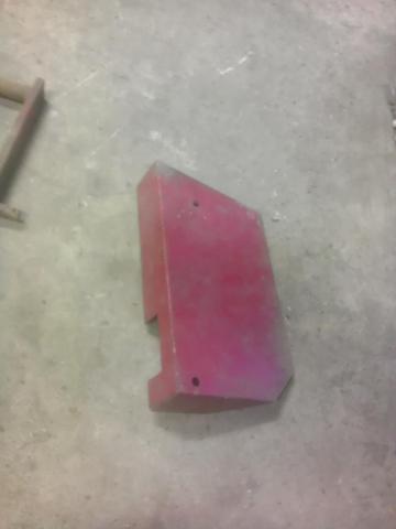

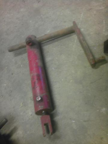

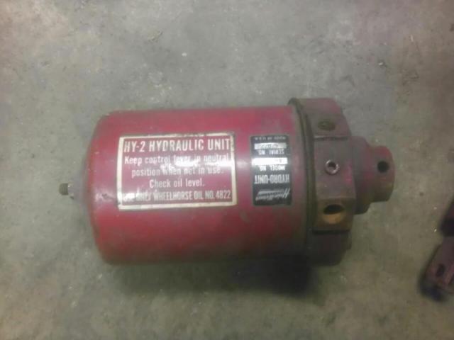

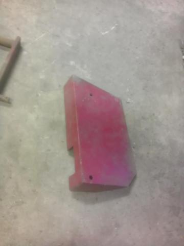

gratefulydeadman 25 #1 Posted March 1, 2013 So I was at a buddys house today and in digging through his boxes of stuff I found an hy2 pump, hydraulic cylinder, and hy2 belt cover. I found and purchased the hy2 rear bracket (the one that mounts to the rear and holds the cylinder) on ebay. Leaving me with needing the rocker arm for the lift, the hoses, 4 groove engine pulley, and the bracket that bolts to the pump and then bolts into the dash tower. So far I have $60 into everything and was wondering if anyone had the missing pieces I need to finish the system. U can message me privately if u want. Thanks ralph Share this post Link to post Share on other sites
Kelly 1,037 #2 Posted March 2, 2013 You have the rockshaft right there, you reuse the part that is already on you tractor with the piece you have sticking out of the ram, but that is only on the 61-62 tractors, you need a dirrent style for the 63-64 tractors, there is no 4 grove pulleys but a add on smaller pulley that is used for the belt to run the pump, send me a PM I probably have all the parts you need, except hoses. Your missing the pump pulley, control handle with knob, lines, pin to hold the cyl. on the rear, the arms for the rockshaft, engine drive pulley, belt, the two brackets that mount the pump to the dash tower, spacers for the belt guard, and if you have a 61-62 tractor the switch relocation box, if you have a 63-64 tractor the part you have for the rockshaft is not right, and you would need the correct rockshaft for that application. Share this post Link to post Share on other sites
