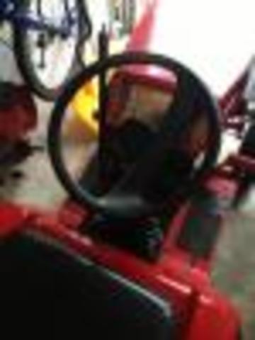

Wheelhorse84
So my new 416 while the front wheels are straight the steering wheel is turned like this. How do I make my wheel straight? post-6185-13619998586_thumb.jpg

i would pull the tower loose and reset the steering wheel and then fine tune with tire rods some body might come along with a better idea though

Check the block on the frame where the steering shaft goes in for cracks. Very common.

There is a collar with a set screw you can losen and adjust the steering wheel with.

like chas said,under the hood look at the steering shaft,you will see a lock collar with a set screw,loosen off the collar,and then pull the steering wheel up a little to lift it out of the lower block,turn the wheel to where you want it,make sure the wheels are straight and push it back down,slide the collar up and tighten the set screw,check for broken sheet metal around the shaft,its a common problem
