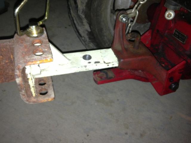

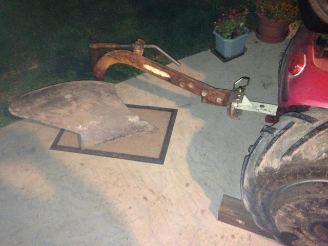

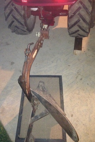

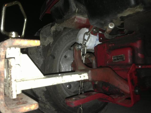

leeave96 496 #12 Posted May 4, 2013 OK time for an update: I thought I'd try a slot hitch instead of the clevis hitch on my tractor. Two thoughts/goals with this approach. 1. I don't think the slot hitch get's in the way of the drawbar as much as the clevis hitch - we'll see. 2. I'm hopeful the slot hitch will pitch the plow up more by viture of it's geometry vs the clevis hitch. So tonight I installed the slot hitch on my '92 year 520H and a slot to clevis hitch adapter - both of which I bought from fellow members - thanks! Below are some pics of my plow set-up, the slot hitch and slot to clevis hitch adapter. At first glance, it looks like I would get a little more lift and depth as the plow sets about 1.5 to 2 inches further out from the tractor than the clevis hitch arrangement. I just hope the plow doesn't move to far to the side and bust the mounting boss at the base of the tranny off the housing! When I set my moldboard plow, I use 4 x 4 pieces of lumber and put one side of the tractor on it, then adjust the depth to that. I've done this for years and have read a lot of others with these old iron tractors do the same. If the weather cooperates, I'll be plowing!!!!!!!! Thanks! Bill Share this post Link to post Share on other sites

6wheeler 675 #14 Posted May 4, 2013 Looks good Bill. Don't forget to put the backing bolts in the hitch to keep the plow straight. I have never broken a boss plowing. I believe there is a better chance of breaking the crosspin or the hitch instead. But that won't happen either. I pull a wheelhorse 12 inch plow with a land wheel on it. I pull it with either the 520 or the 165 neither of which have any trouble with it. My ground is clay/gumbo and usually wet. I plow about 3/4 of an acre every year with no trouble. If it ever stops snowing here, I will be plowing soon as well. If there is a weak area on this setup? It is the hitch on the plow itself. Where the flat iron is welded to the hitch itself tends to bend. I welded a brace on mine. But outside if that? No problems. On the C-165? I plow in high range 2nd gear and she handles it with no complaints. With the 520h I just try to go approximately the same speed. I don't use lug tires (although it would probably work better). I am stubborn and as both tractors get lawn duty as well, I don't want to tear up the grass ( my wife thinks I am just a bit whiney about that, she may be right). I do put 50 to 100 pounds of suitcase weights on the front ends, so I can keep them on the ground and steer (it does tend to get "light" if the going gets tough) and stay in the furrow.For me? Spring plowing works the best. I end up with a relatively weed free garden as all of the weed seeds end up too deep to germinate. Moldboard plowing IS way more fun than snowplowing. There is just something about green/brown weeds and trash from last years garden in front of you when driving, Turning black behind you when plowing. Its just Too Much Fun . Enjoy..... 1 Share this post Link to post Share on other sites
953 nut 64,198 #15 Posted May 4, 2013 That little crank thingie is what will set your plowing depth, the further you tilt it forward ( point going down ) the deeder it will want to go. In the fall I cover the garden spot with ground up leaves and plow then under. In the spring I plow in one direction, come back in two weeks and replow the other way, 90 degrees from what i had done the first time; then disk and rake out the stones and clay clumps; then disk again. This may seem like a lot of work, but look at all the seat time I get! Share this post Link to post Share on other sites

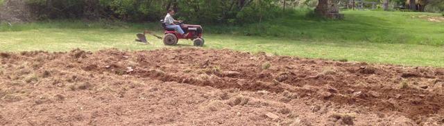

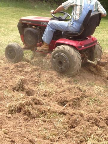

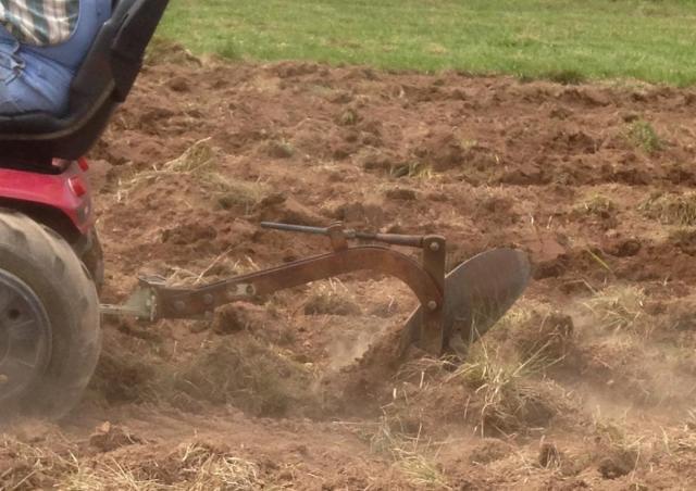

leeave96 496 #17 Posted May 4, 2013 OK - just got back from plowing and it was at best a mixed bag. The garden I am working is one I use to work several years ago and so basically what I was looking at was turning virgin sod for all practical purposes. I've tried to plow heavy sod this with the Wheelhorse in years past and found it to be difficult. Since this plowing was more about having fun and seat time, I plowed the garden and disc'd it up with my fine 51 year old Massey Ferguson Model 50 Diesel. Today's effort was to turn things again to help break-up what's left of the sod. I found no advantage to using the slot hitch vs the clevis hitch. Given the ground had been previously worked, the landside of the plow really didn't have solid ground to hold the plow from moving from side to side and sometimes it swayed more than desired. I know you can use the bolts on the sleeve hitch to stabilize the plow, but my understanding is that this shouldn't be used on a moldboard plow and I've never done it or needed to - until maybe today. Another problem I had was there were still some substantial size chunks of sod and they would get under the plow and not let it go to depth - sometimes frustrating, but hey, a bad day of plowing with a Wheelhorse is better than a good day at work - right? I used my 520H tractor with Matt's foot control kit. Prior to going out I made some needed adjustment to it so I was truly stopping when my foot was off the pedal. Prior to this, the tractor wanted to creep backwards. The foot control worked GREAT!!!!!!! In years past, it was a handful to look back at the plow and keep a hand on the hydro lever. Not a problem today. Also, traction was never a problem with my old hard warn ag tires w/ wheel weights. My final frustration of the day - and the one that made me put the tractor on the trailer for the trip home, was about 3/4 of the way through plowing the garden, the tractor started surging - like it was starving for gas. Sure enough, I looked at the fuel filter and it was almost bone dry with only a tad of fuel dribbling into it. I scooted the tractor as quickly as i could to the trailer and called it a day. Don't know if I'm going back to this garden with the plow or just till it in and get stuff planted, but I've still got a small garden I'm going to plow at my house, so I'll try things again later this week. I'll post some pics later tonight. Thanks! Bill Share this post Link to post Share on other sites

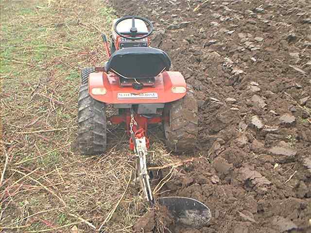

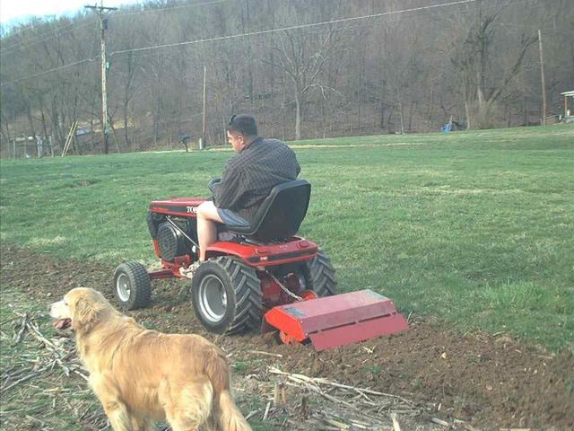

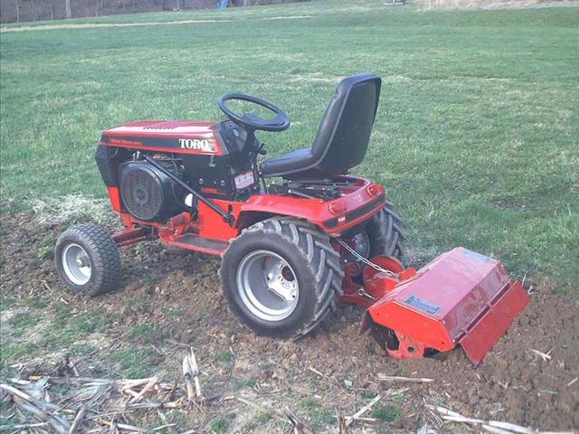

wh5208speed 669 #21 Posted May 6, 2013 Working a garden is about the most fun you can have on a Wheel Horse. Here is a photos of C-121 tearing it up with moldboard in the fall, followed by 520-8 with the tiller in the spring. Thad (Ohio) 1 Share this post Link to post Share on other sites
leeave96 496 #22 Posted May 6, 2013 Working a garden is about the most fun you can have on a Wheel Horse. Here is a photos of C-121 tearing it up with moldboard in the fall, followed by 520-8 with the tiller in the spring. Thad (Ohio) Do you have your lift chain hooked to the plow vs the clevis hitch? Share this post Link to post Share on other sites
wh5208speed 669 #23 Posted May 7, 2013 The chain is hooked to the clevis. It just looks like it is hooked to the plow because of the angle of the photo. Thad Share this post Link to post Share on other sites
