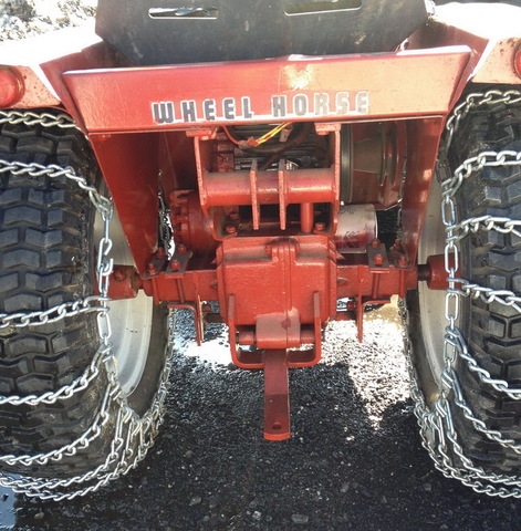

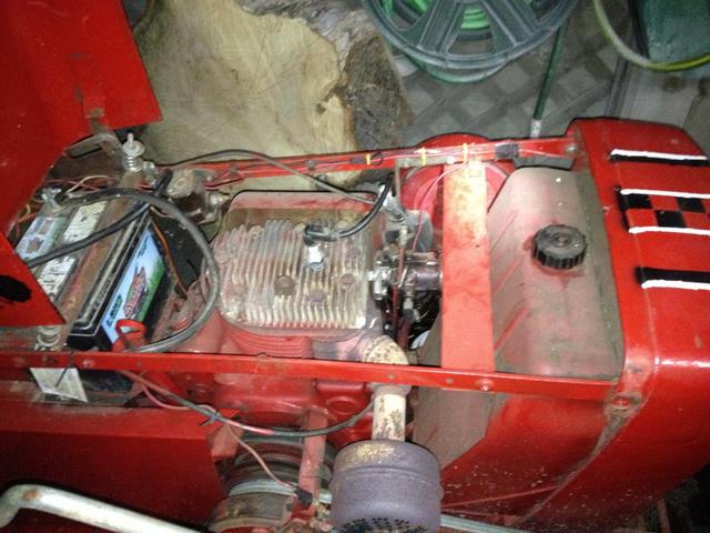

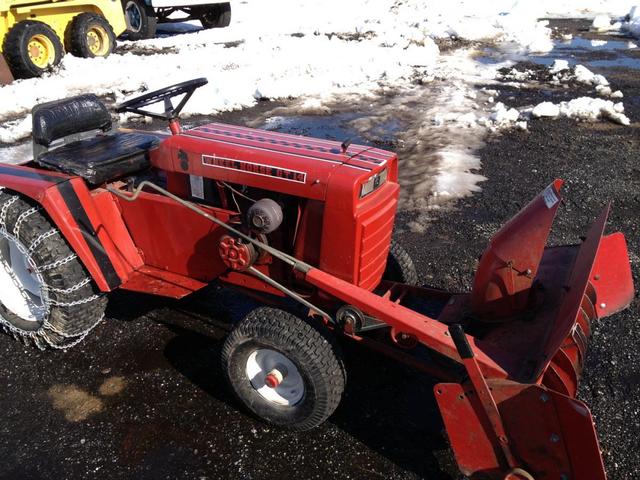

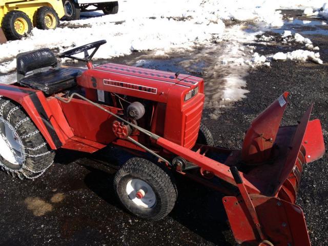

Machria 78 #1 Posted February 13, 2013 Hey guys, Just bought what looks like a 1971 GT14, my first tractor. I'm pretty sure I have lost it, but what the heck, you only live once! I runs ok, but needs a tune up and cleaned up a bit. But it's in pretty decent shape I think. With the throttle way up, it will backfire once in a while (every 5 or 10 seconds) with fire out the muffler. Also, it seems to get bogged down and stahl if I give it anykind of heavy load. I went into some very wet 6 or 8" deep snow and it bogged down and stalled only a few feet into it. I'm pretty sure it should do better than that. First thing I will do is give it some fresh fuel, run some sea foam thru it, change the plug and oil. Then see how she does. Anything else I can do in short order? The throttle also won't stay out, it pulls itself back in like it is spring loaded or something, so something needs fixed/adjusted there. Lastly, the lights and snow blower worked when I got it home, but I then tried pushing in the cig lighter to see if it worked and afterward the lights stopped working and I could not engage the snow blower. I'm guessing I blew a fuse somewhere I hope, but a quick look around and I could not find any fuses anywhere? I'll need the manual to find things, anywone know where I can get the exact manual for it? In the manual section there were similar model manuals (other GT14's) but none that matched my model number? Model: 1 0500 6 Sn# 825066 Things I need: 1. Manual 2. I'd like to get a small geni to connect to the front or back (I have the extra pully in rear) of this thing, where do I get that? 3. Standard hitch mount adapter (I understand somebody on here makes one for these?)? 4. Front headlight lens, it is cracked and broken. I'd like to replace the lights with LED's or something? 5. Better muffler, this thing is loud! What's an easy install better muffler? Thanks for any help in advance. Anyone interested in coming over to have a look at it, I'll supply $$ and beer!! Share this post Link to post Share on other sites

meadowfield 2,945 #4 Posted February 13, 2013 Hi, good choice re: back firing, more than likely poor mixture caused by clogged airfilter, bad gas or more than likely blocked jets/dirt in carb. This could also be the loss of power too - though that could be fixed by new coil/plug/points.... Is the choke actually working? that could also reduce power and bog things down... manual is on the toro site - apart from the hydro, any GT14 manual should get you started! LED lights yes - good idea and they work well mark Share this post Link to post Share on other sites

KC9KAS 4,745 #6 Posted February 13, 2013 :WRS: You need to remove the battery, and you will find a fuse that feeds the (accessories) electric clutch/lighter/lights. The lighter probably has a little rust in it, and blew the fuse when you tried the lighter, ot the lights on and lighter pushed in was to much of an amp draw for the fuse. Very nice looking GT-14! Share this post Link to post Share on other sites

Machria 78 #9 Posted February 14, 2013 Thanks guys. Tuned it up a bit tonight, new plug, cleaned the air filter (was a mess), sea foam and fresh gas, changed oil, wd40... Then found the blown 30 amp agc fuse and replaced. MUCH better. Everything working, and running much better. It still backfires if I go from full throttle to a low throttle setting quickly, but I'm guessing that is just how this engine runs, yes? My only problem left is, the throttle. It won't stay where I put it. It just pulls it back in, so I have to hold it in position. A quick look at it could not figure out why it's getting pulled in? Share this post Link to post Share on other sites

KATO 115 #11 Posted February 14, 2013 Auction site = E-BAY. About your throttle cable , try turning it clockwise when you pull it out into position. it should be a locking throttle cable. if so you will feel it tighten up when you turn it. if it doesnt you probably need a new one. Or some one has replaced it with a choke cable which is a non locking cable. Share this post Link to post Share on other sites
Machria 78 #12 Posted February 14, 2013 Auction site = E-BAY. About your throttle cable , try turning it clockwise when you pull it out into position. it should be a locking throttle cable. if so you will feel it tighten up when you turn it. if it doesnt you probably need a new one. Or some one has replaced it with a choke cable which is a non locking cable. Thanks, dopey me, I downloaded and read one of the manuals last night and noticed the note about "locking throttle". Haven't tried it yet, but I'm sure it will work fine. Share this post Link to post Share on other sites

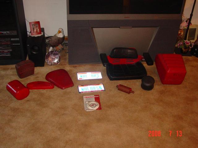

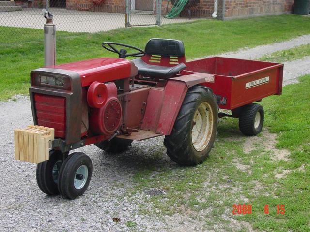

Brrly1 1,146 #18 Posted February 15, 2013 (edited) Alrighty then,here's what I did for a couple of my GT14's. If you have a Tractor Supply in the area go there ,go to the muffler area. You should be able to find a I.H. muffler for around $25 or so shouldn't be a whloe lot more than that. Look for a flapper that would mount on top( don't need the rain to lube anything)You might ask the person helping if they have any of the black steel pipe, if they do great if not run by a Lowes or Home Depot and pick up what you need. I would advise taking measurements before you leave the house so No multiple trips. I am going to post a couple pictures here for you. Good Luck If I can do it, I am sure someone else can do the same. Enjoy the pictures! Nothing in these photos are For Sale. Don't bother to ask because it won't happen. Look to the right side of the photo with all the items. You'll spot a GT14 NOS muffler, new lift cylinder, new fuel tank, New 2 piece seat. Have fun!! Edited February 15, 2013 by Brrly1 Share this post Link to post Share on other sites

Machria 78 #20 Posted February 16, 2013 brrrrr, What are those wooden things with handles on them on the front of the tractor? Is that seat for sale? I need one! We don't have a Tractor Supply on Long Island. Share this post Link to post Share on other sites
Brrly1 1,146 #21 Posted February 16, 2013 The front pieces on the tractor are suppose to be front weights. Sorry that seat is for my Dads tractor. Those are some of the things I have collected over the years. All the GT14 parts are headed for his tractor. I can understand the part of no Tractor supply. Keep you eyes on ebay, every so often you'll have a two piece seat show-up. Theres been times that I have seen them go for around $70 or so, plus shipping which is not to bad. Share this post Link to post Share on other sites
