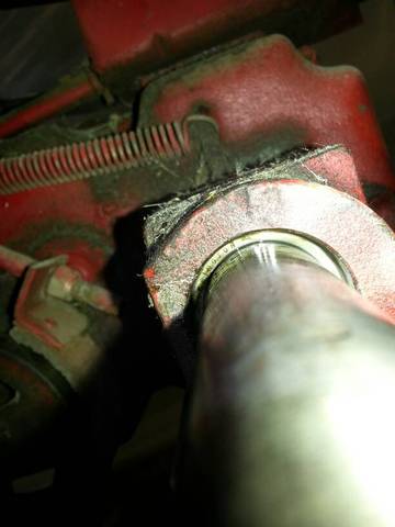

redrooster 83 #26 Posted December 19, 2013 Will the old seal have metal in it? When i was removing the old seal i picked out very little rubber material before running into metal. I assumed this was the bearing. Is it possible that i do not have the old seal fully removed? This is all I could remove if the axle seal. The new seal I got measures 15/8". No way will that go back. I'm guessing I have the wrong seal and maybe not getting all of the old one out???? Sent from my SPH-L710 using Tapatalk I Sent from my SPH-L710 using Tapatalk This is all that I could remove of the axle seal. The new seal I got measures 15/8". No way will that go back. I'm guessing I have the wrong seal and maybe not getting all of the old one out???? Sent from my SPH-L710 using Tapatalk Sent from my SPH-L710 using Tapatalk Share this post Link to post Share on other sites
John Voss 76 #27 Posted December 19, 2013 That is definitely the wrong seal. This is the correct seal. http://www.ebay.com/itm/281192492884?ssPageName=STRK:MEWNX:IT&_trksid=p3984.m1439.l2649 Share this post Link to post Share on other sites
stevasaurus 23,812 #28 Posted December 19, 2013 redrooster, that new seal that you show in the picture above, looks like the cap seal for the 3 piece RJ/Suburban transmissions. It sets on the outside of the axle housing in that application. Did you get that from TORO??? WH # 1257 renamed 83-2840 cost about $18 apiece?? It is the wrong seal for sure. It should look like the old one. Share this post Link to post Share on other sites
redrooster 83 #29 Posted December 19, 2013 Is this seal all plastic and rubber Share this post Link to post Share on other sites
redrooster 83 #30 Posted December 19, 2013 Got from toro #6449 . Ill have to go back and beg for mercy and they will be mad at me. Ill be lucky if they are nice and give me an even exchange. Share this post Link to post Share on other sites
Kelly 1,038 #31 Posted December 19, 2013 The new seal posted above looks like a seal for a hydro trans 1 Share this post Link to post Share on other sites
Lars 526 #32 Posted December 19, 2013 The new seal posted above looks like a seal for a hydro trans yep thats right!! Share this post Link to post Share on other sites
gwest_ca-(File Mod) 12,478 #33 Posted December 20, 2013 Got from toro #6449 . Ill have to go back and beg for mercy and they will be mad at me. Ill be lucky if they are nice and give me an even exchange. Curious to know how/why you got the wrong one. Did you order the 6449 or was it the dealer? Garry Share this post Link to post Share on other sites
