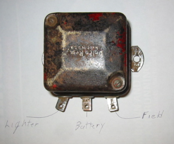

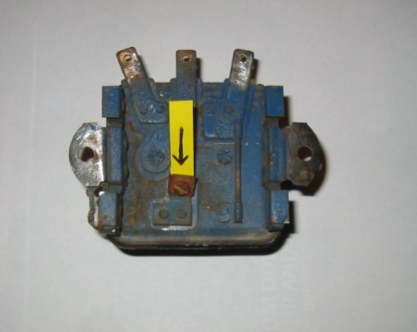

Packrat 2 #1 Posted February 10, 2013 I am rewiring my 875 and need some help ... I know where the wires go on the front side of the regulator go but don't know where the one on the bottom of the regulator go's .. And is this the right regulator for this one ???? There are no numbers on it .. Share this post Link to post Share on other sites
TT-(Moderator) 1,162 #2 Posted February 10, 2013 The terminal on the underside of the regulator connects to the armature ("A") post on the starter/generator. Although it looks like the right voltage regulator..... you'll have to see if it works correctly. :confusion-shrug: Share this post Link to post Share on other sites
