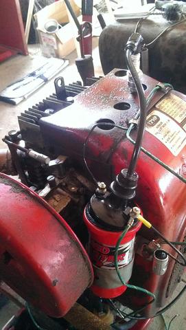

SousaKerry 503 #1 Posted February 8, 2013 Friend of mine who is trying to get spark back on his C-121 Auto went out and purchased a MSD coil from an auto parts box store got one hell of a surprise this morning when the coil blew apart in his face spraying hot oil everywhere. Fortunately he was not in direct fire and oly had to change his shorts (pun intended.) According to what he tells me everything is wired correctly even if it wasn't I don't see how this could have happened. Share this post Link to post Share on other sites

305 380 #4 Posted February 8, 2013 the MSD blaster coil is very low ohms and requires a ballast resister for use with points Share this post Link to post Share on other sites
Kelly 1,037 #5 Posted February 8, 2013 I was going to add you need a ballast resistor with that coil, to drop voltage to about 9v, I had a coil blow up when I was charging a batt. and had left the key on, it made a mess all over everything and was a loud bang when it happened, luckily I was about 10 feet away. Share this post Link to post Share on other sites

clemedc 29 #10 Posted February 8, 2013 A standard coil used on a Kohler has an internal resistor, automotive coils do not. You can and I have used automotive coils "in a pinch" with the resistor put on the 12V wire that powers the coil Share this post Link to post Share on other sites
