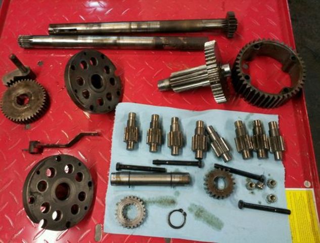

Callen 64 #1 Posted February 8, 2013 Can anyone tell me if the D series parking paw will fit in a 16 auto transaxle? This is what it looks like in the top left corner. Share this post Link to post Share on other sites
Trouty56 567 #2 Posted February 8, 2013 Is that the D series pawl there?? I have a pawl out of a B-100 auto...looks the same but I can't tell what size that is. My guess would be....yes!!! Share this post Link to post Share on other sites
TT-(Moderator) 1,167 #3 Posted February 8, 2013 A very quick check of the IPL's show different part numbers for parking pawls used on the 16 auto vs. the D series. The B-100 does show the same #103888 pawl as the 16 auto. (In case Bob wants to give his up) The D series pawls I saw were P/N 103350 Share this post Link to post Share on other sites
