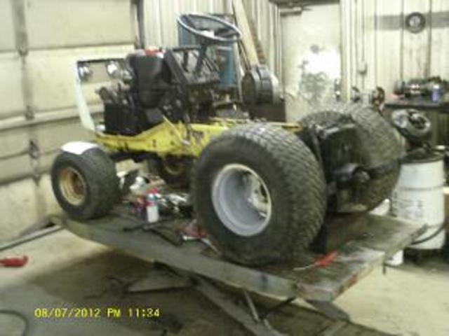

diesel cowboy 263 #20 Posted February 7, 2013 Heres the one I use at work. Has 4 different height adjustments so you can work on the top of the engine or be able to get at the underside of the tractor. I think it was originaly sold as a motorcycle table and they had extensions for a snowmobile . We have the extensions and about the only thing we have trouble putting on it is the zero turn mowers cause they're just to wide. And the tractor thats on it is just about at the limit of what it can handle at a little over 900 lbs and 42 1/2" wide and 7 1/2 feet long. Thats front to back with the 3 point lift arms Share this post Link to post Share on other sites
