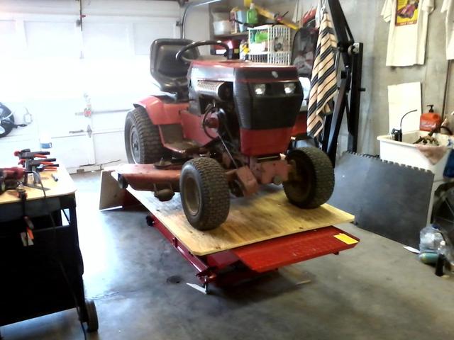

Torino 15 #52 Posted February 18, 2013 Here is a pic of my 520 on the lift. Drove up easily and is steady. It is nice not having to break you back and knees. If you are on the fence about getting one I would. I put some shelving board underneath the plywood so all the weight would not be on the turned up edges. Thinking of putting some flat steel between that and the plywood. It seems to be ok with the 3/4 plywood but it's better to be safe than sorry. Share this post Link to post Share on other sites

fireman 1,022 #55 Posted February 19, 2013 I would consider bolting the plywood down to the metal top. If you're working and the tractor and you slip and lean on it hard, the plywood could shift and send it off side. Good idea to put some cross bracing under where the tires will normally rest. How is the tip factor on the base? Does it feel steady when it's at a comfortable working level with the tractor? For $299 this is a must have for anyone who spends a good amount of time working on their tractors (or anything else for that matter Lawn mower, motorcycle etc.)! If I didn't buy the one I did, i'd be there it a flash to get one. Share this post Link to post Share on other sites
Torino 15 #56 Posted February 19, 2013 I forgot to mention I did bolt the plywood down. I had the 520 where the hood was almost eye level and it seemed very stable. I am sure you could push it over if you wanted to but I was surprised at how stable it was that high. I think it you use common sense and don't compromise the lift it will work fine for normal wrenching. If someone is good with fabbing and welding I am sure they could make some metal side extensions that could be taken on and off. Share this post Link to post Share on other sites
