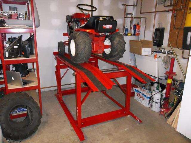

73-18 automatic 8 #27 Posted February 9, 2013 This is what I made last summer and itis really easy and handy to work on tractors Share this post Link to post Share on other sites

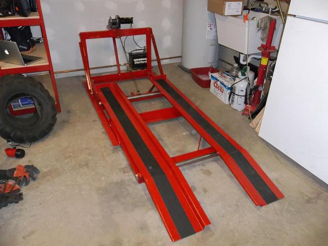

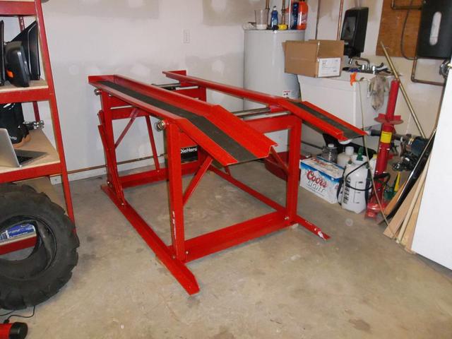

sorekiwi 761 #28 Posted February 9, 2013 I too suffer from a worn out back, so on my longer term projects I need something to lift them up a little. These small wooden stands are the ones that get used the most: Years ago I built this to work on the RJ58 I used to have. It worked great for that, but it's not so stable with a bigger tractor on it. And one day I am going to do this: 3 Share this post Link to post Share on other sites

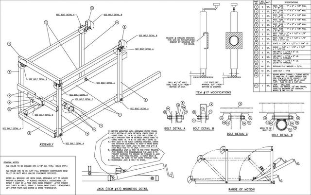

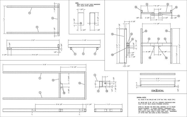

JUSS10 250 #29 Posted February 9, 2013 Alright so i had some time tonight and decided to draft up that one design in solidworks. This is a rough model based on what i could figure from the pictures on that website. I haven't figured out just how much steel is in it, but there is a LOT. I'm guessing on the top construction but the base seems pretty spot on. It seems over kill. I may try and re design it to lessen the steel amount. Anyway here are some screen shots. Obviously for a tractor you would have to add wings, I was just showing it the way the website showed it. It could be widened overall as well. Share this post Link to post Share on other sites
fireman 1,022 #30 Posted February 9, 2013 Just a suggestion! Don't add wings to the lift. My first lift had a narrower base than the top and it was kind of dangerous. Was ok if you didn't lean or shake it to hard. I would suggest making the base close to the same size of the top. Your other option could be to add swing out stabilizers that would add some stabilization when it was up in the air. 1 Share this post Link to post Share on other sites

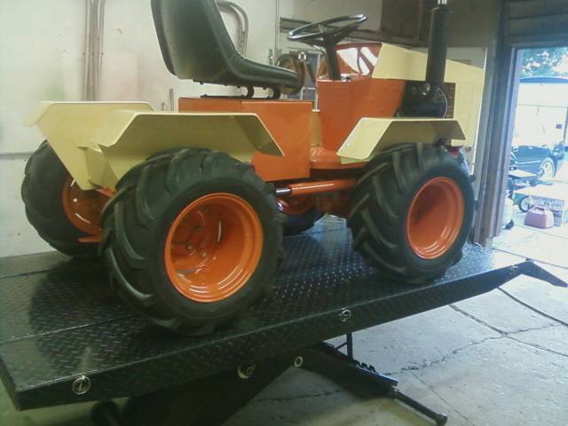

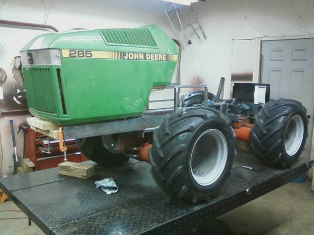

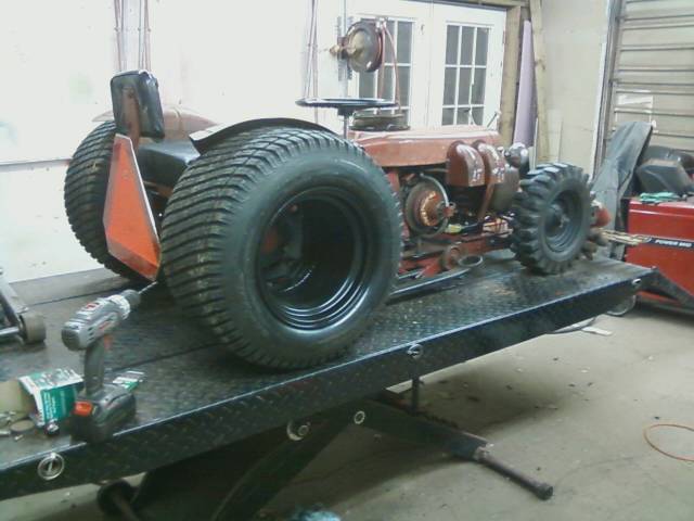

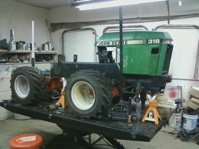

whlpny 203 #31 Posted February 9, 2013 I bought a Direct Lift Pro-cycle/atv lift 2 years ago- its the best shop investment I have ever made. Its rated at 1,000lbs lift but it will do more -I've done an easy 1200lbs with it. Under no circumstances will I ever work on another tractor on the ground again. The cost is worth the bodily pain saved in the knees and back. The Pro-cycle gets the added wings to make the table 4ft wide so its perfect for my 4x4 builds. You can see the removeable ramp in the first pic- its off in the other build pics. Its easily removed so you can get up close to work on the ends. The walker hanging up in the top corner in last pic is what I will use from not buying this lift sooner ! 2 Share this post Link to post Share on other sites

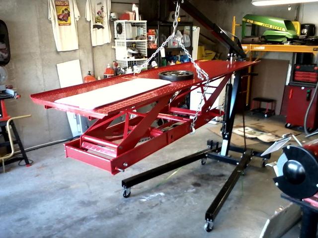

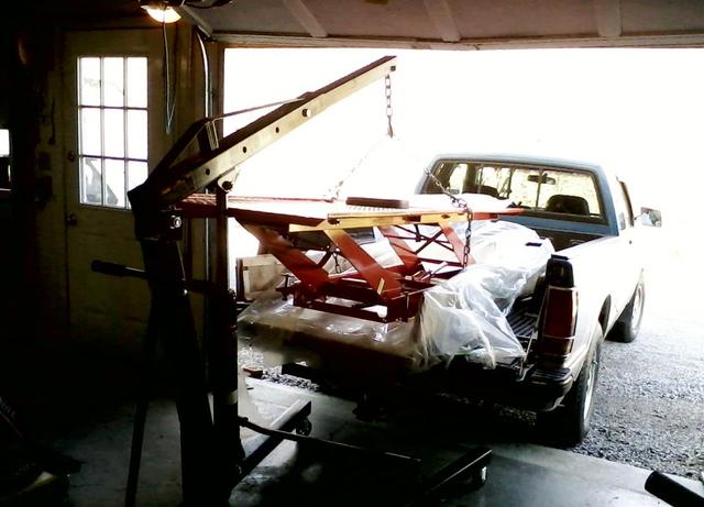

Torino 15 #43 Posted February 15, 2013 Well I got it yesterday got it home and set it up. I used an engine hoist to get it out of the truck. What I thought I would do is put 3/4 plywood on top to the width I needed and go from there. It that is not strong enough I will see what I can do to support the part that will be hanging over the top of the lift. This way I can use it as a work table to. I am also thinking of extensions on the side also. Does anyone have a pic of how they install? Share this post Link to post Share on other sites

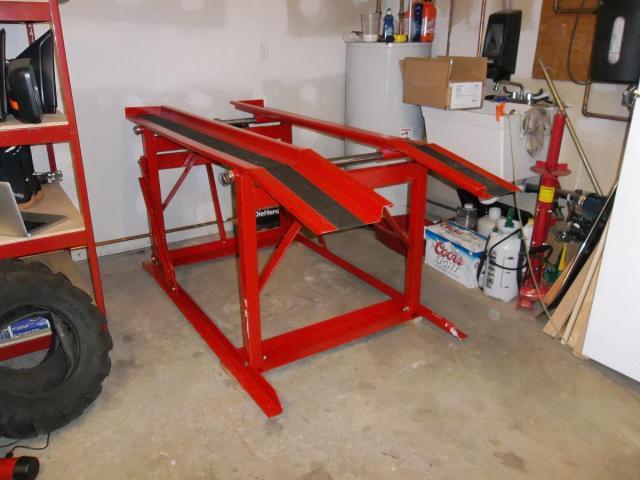

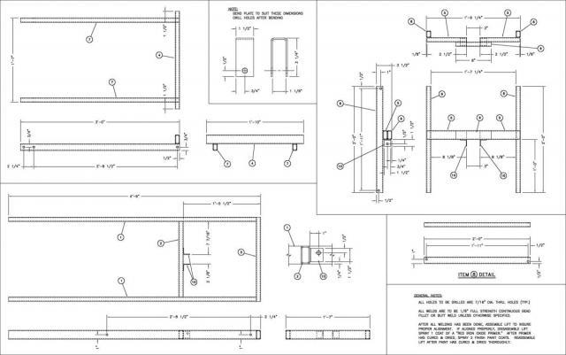

855ownerJoel 32 #47 Posted February 16, 2013 I love my lift. My back loves my lift. The ramps adjust side to side for width. I found this on CL in PA last summer. I have never seen another one like it. It appears to either factory made or by a true craftsman. Paid $300 and spent a weekend cleaning, sanding, and re-painting. If anyone is interested, here is a set of plans for a snowmobile lift. You can easily put a top on it and use it for a tractor. Looks very simple to build: I also have a set of plans in PDF for a motorcycle lift which will work fine for a tractor. If anyone is interested I can email you them. Spending the day in the shop making a lift similar to the one you purchased. Ordered up the ramps all bent and set up similar to your picture. Picked up the additional steel that I did not have around the shop. I am going to use a boat trailer crank set-up to lift the lift and lower it. Really cannot wait to use it! Share this post Link to post Share on other sites
sorekiwi 761 #48 Posted February 16, 2013 I'm betting that it would cost more than $299 to build one - although it appears you still need to spend a bit on the HF one to widen it a little. Share this post Link to post Share on other sites
