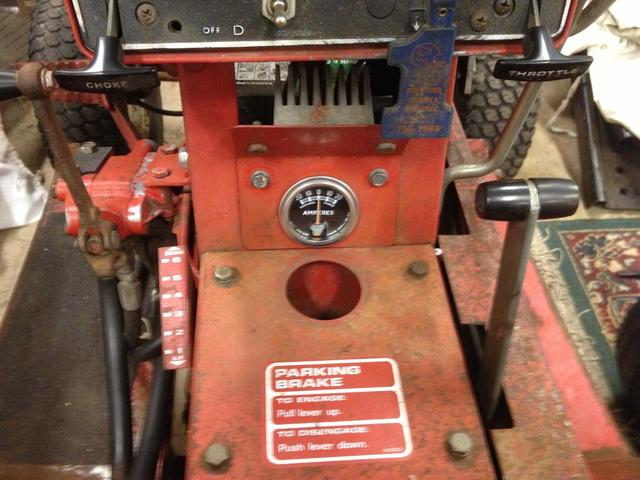

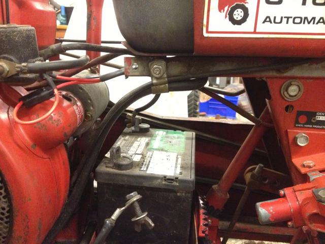

Martin 2,133 #29 Posted February 21, 2013 got the harness all installed and everything works. even changed out headlight/taillight bulbs and now have lights too..... but most importantly now the wiring is safe..... bit hard to photo the harness under the hood stand but heres the rest of it installed. had a + wire to the area where an hour meter would go so i might hunt one down and install it... 1 Share this post Link to post Share on other sites
