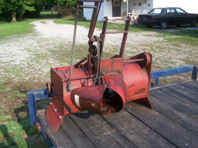

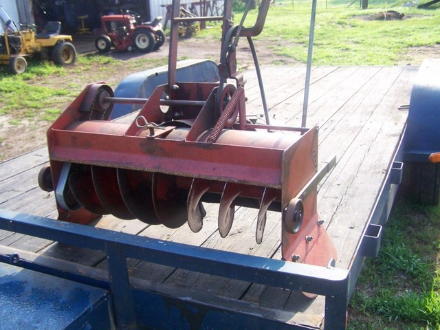

546cowboy 302 #1 Posted February 2, 2013 (edited) I have a snow blower that I got with a 1965 655 what other models would it fit> Would it work on a 876? Edited February 2, 2013 by 546cowboy Share this post Link to post Share on other sites
SousaKerry 503 #3 Posted February 2, 2013 (edited) Does it still have the model number tag? From here that looks like a later model snowthrower for a quick a tach tractor, post 1973? Edited February 2, 2013 by Sousakerry2 Share this post Link to post Share on other sites

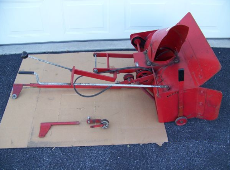

TT-(Moderator) 1,169 #4 Posted February 2, 2013 Does it still have the model number tag? From here that looks like a later model snowthrower for a quick a tach tractor, post 1973? These throwers have a belt engagement assembly because the tractors they fit don't have a PTO clutch. Pre Attach-Matic throwers have a longer mounting frame and attach directly to the tractor frame. The mounting frame also angles upward - meaning it's for a tractor with full-size tires. The Lawn Ranger thrower mounting frame was straight. Here's a picture of a 6-2211: @Lynn: do you have the guide idler assembly? Share this post Link to post Share on other sites
546cowboy 302 #5 Posted February 2, 2013 (edited) I bought the tractor from a guy who said it came with his house. He said an older man owned it since new with deck, plow and snow blower. The reason I asked the questions was someone contacted me and asked if I had a blower that would work on his 876. I bought it about a year and a half ago and the engine had a broken rod. I have replaced the engine with a Harbor Freight 6.5 hp. I really don't need the snow blower. Edited February 2, 2013 by 546cowboy Share this post Link to post Share on other sites
Jim_M 179 #6 Posted February 2, 2013 (edited) It should be a direct fit on the 876, if it's what it looks to be in the pictures. I used one on a C-160 for a while. Had to replace the bolt with a piece of 3/4" round stock and find the right belt. It got me by for a couple of winters. Wheel Horse stuff is pretty versatile if you use your imagination. Edited February 2, 2013 by Jim_M Share this post Link to post Share on other sites
