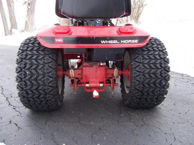

wh5208speed 667 #3 Posted February 1, 2013 If you are looking for a hybrid between ag and turf tires....I really like the Carlisle All Trail Field Thad (Ohio) 1 Share this post Link to post Share on other sites

thehorse 221 #8 Posted February 4, 2013 I found a set of the all trails but when mounted would not clear with chains.....bummer Share this post Link to post Share on other sites
