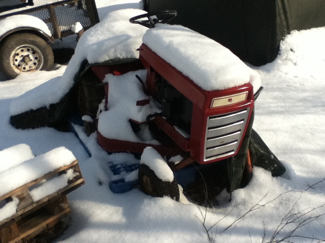

farmerall 23 #1 Posted January 29, 2013 I bought this about a month ago from a friend of a friend. I was told that it was his grandpas tractor and it hadn't been touched since his grandpa passed away about 10 years ago. His grandapa repainted a lot of it and it looks like he did a good job too. I pu tsome gas in and jumped the battery and it fired up after a few seconds and ran pretty good. I haveno clue what I'm going to do with it but I couldn't pass it up for 50 dollars. 2 Share this post Link to post Share on other sites
posifour11 723 #2 Posted January 29, 2013 I wouldn't be passing it up either. Another one finds a loving home. Share this post Link to post Share on other sites
Wheel-N-It 2,976 #3 Posted January 29, 2013 That might be the best 50dollar lawn tractor you will ever buy! I know what I would do with it. I would sweep the snow off and take it home with me :) Share this post Link to post Share on other sites
welderman85 53 #4 Posted January 29, 2013 Great buy Share this post Link to post Share on other sites
Jake Kuhn 1,579 #5 Posted January 29, 2013 Looks pretty nice! and what a great price too! :handgestures-thumbup: Share this post Link to post Share on other sites
Kelly 1,033 #6 Posted January 29, 2013 I've got one of those here that I picked up for $25, years ago, my son Ryan use's it to sweep leaves in the fall, mine has a 42" RD deck, it's just a mower but does pretty good, I think the trans is going out of it but heck 3 years for $25, it's been good to us. Share this post Link to post Share on other sites
VinsRJ 723 #7 Posted January 29, 2013 Looks like a nice unit... good luck with it! Share this post Link to post Share on other sites
TT-(Moderator) 1,162 #8 Posted January 29, 2013 A few years ago I won this B-112 on eBay for $22 I stuck another engine on it and my son beat it around for a while. When he was done, I saved a the good pieces and scrapped the rest. The mower deck went to one RS member who was going to convert it to use on a garden tractor and the narrow front axle went to another member for his pulling tractor. I guess verts aren't totally worthless. Share this post Link to post Share on other sites
farmerall 23 #9 Posted January 29, 2013 I would sweep the snow off and take it home with me It is home. The tarp blew off and it snowed on it. Unfortunately I don't have anymore space to store it inside right now. Share this post Link to post Share on other sites
855ownerJoel 32 #10 Posted January 29, 2013 Looks pretty nice from what is visible, good find and a bargain! Anything that runs alone is worth $50.00 to me, cannot buy the engine for that. Share this post Link to post Share on other sites
