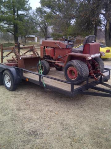

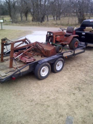

brandonozz 168 #1 Posted January 27, 2013 I ahve been thinking about getting this for a while, but honestly, didn't have the room for it until I got my garage built. I'm hoping I will be able to get it going with the great members here at RS. I will give you some background and hopefully you guys with experience can give me some advice. I picked up a '79 D200 (model 91-20KS02) with PTO shaft and 3 point hitch ,48" deck with seased spindles, heavy steel weight counter balance and (YEA!) 48" FEL (model 07 48FL01). The tractor hasn't ran in about 6 years. The PO was using the FEL when he heard a "pop" and found lil leaking from the rear diff. He found the case cracked on the bottom right half of the case. The tractor has been parked ever since. The PO inherited the tractor from his father who actually had two D's and collected quite a few spare parts as well. One spare part was a diff that was repaired because it had been cracked in exactly the same way as the one curently under the tractor. The spare diff appears to have the crack silver soldered with a plate covering the motor mount so I'm hoping it was gone thru with new bolts but the PO was not sure of the repair. I understand the bolts were a weak link in these diff - I think the bolts needed to be changed out with grade 8 bolts?? So, take a look and tell me what you think of my find. Here are my questions I would like you experts to please chime in on as I have ZERO hydro experience. I believe the 10W-40 oil circulates thru the hydro pump, motor, diff and the lift cylinders - is this correct. If so, would the diff being would you flush the entire system of any debris or would the filter in the diff keep the ""trash" isolated in the diff? I have some questions about the hydro mannifold connections but I will save them for the trans forum. Thanks in advance for your input! 3 Share this post Link to post Share on other sites

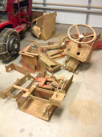

brandonozz 168 #2 Posted January 27, 2013 Here are the extra parts i got. Fenders, hood, steering with a spare hydro as well lots of misc stuff! These are filthy from sitting in a barn for a looong time. 1 Share this post Link to post Share on other sites
WH-PWR 62 #3 Posted January 27, 2013 Great Find!!! Anytime you find a Wheel Horse with a front end loader, to me it's a great find. Keep us posted with your progress. Share this post Link to post Share on other sites
Jake Kuhn 1,598 #4 Posted January 27, 2013 Nice haul!!! :handgestures-thumbup: Share this post Link to post Share on other sites
brandonozz 168 #5 Posted January 27, 2013 Kinda kicking myself now for not pulling the trigger quicker. The PO had a tiller also and by the time I went back to get everything he had GIVEN it to a neighbor! i told him to let the guy know if he ever wants to part with it just let me know. Share this post Link to post Share on other sites
