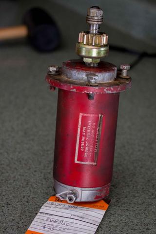

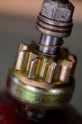

qball16 0 #26 Posted February 20, 2013 Oh, I forgot, you all like pics. Here are a few....... Share this post Link to post Share on other sites
qball16 0 #27 Posted February 20, 2013 Last thing. How do I become a "Dysfunctional "D" family member� Is it a simple matter of ownership? Does my bloody knuckle get me in the gang? Is there some sort of hazing ceremony? What if want to get out? Am I stuck in it for life? I have also lined up a friend's husband who is going to get the motor running for me. He specializes is boreing and re-sleeving motorcycle engines so I think he will be able to get it going. He could replace pistons and rings if I need it, too. I only had 30psi on one side, 90 on the other. I don't know if results are accurate when you just turn the motor over by hand, though. We shall see......... Scott Share this post Link to post Share on other sites
JamesBe1 84 #28 Posted February 21, 2013 Thanx for the update Scott. So it was the drive gear all along? What goes bad with them? 15Deg is plenty cold, I don't do much with my tractors this time of year. I am waiting till the spring gets here to install a new exhaust valve. I really don't feel like going out the the shed and getting dirty in the cold. No need for hazing to join the dysfunctional family. I think you've proven yourself already. I think you just need to edit your 'Member Title' in your general account settings. Welcome to the family! Share this post Link to post Share on other sites
