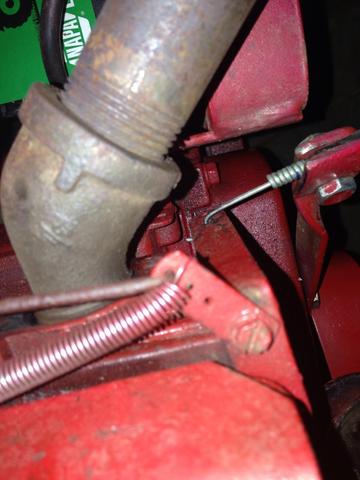

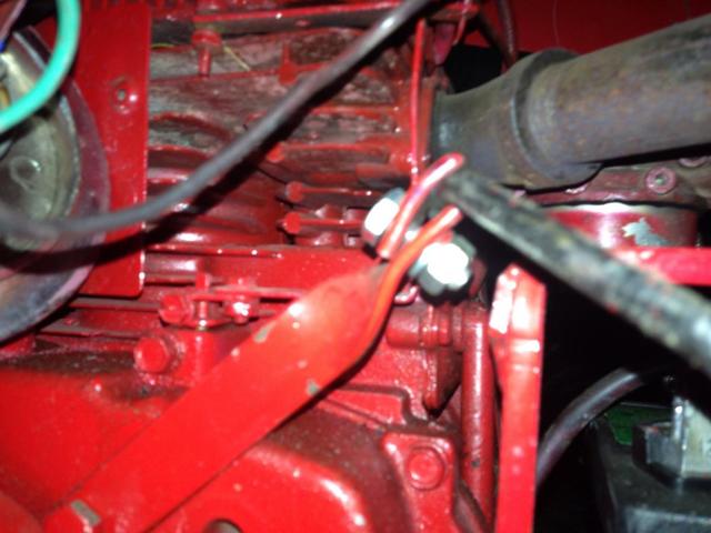

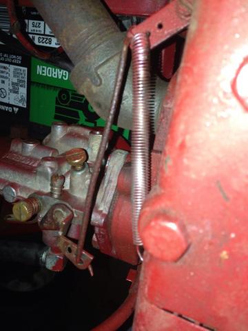

Pilot101 2 #1 Posted January 22, 2013 I have a 551 that has an H60 on it. I believe I am missing the bracket and linkage assy. The throttle cable is connected to the governor arm towards the lower end.( the vertical part of the arm) and the upper part of the arm has linkage from there to the carb throttle. I am going to attempt to get some detailed pics. Also I am looking for the starter cup for the flywheel but the two part numbers I get , the cup is to small in diameter and will not allow the starter dawg assy to sit inside of it.. The part numbers I come up with after all the superceedings are 35287 and 37966. Hope this is enough info.on. Share this post Link to post Share on other sites

puddlejumper 67 #3 Posted January 22, 2013 Drop down 9 or 10 topics to tecumseh h60 on this forum kiwi has some pictures posted that are the way all of mine are hooked up. It looks like you are hooked directy to the govenor and there should be a spring in the equation that will allow the govenor to do its job as it is now it cannot adjust itself. 1 Share this post Link to post Share on other sites
ol550 864 #4 Posted January 22, 2013 Your current linkage setup will not allow for governed speeds. The pic shows your missing part. Share this post Link to post Share on other sites
