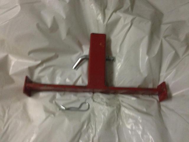

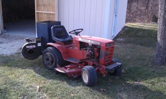

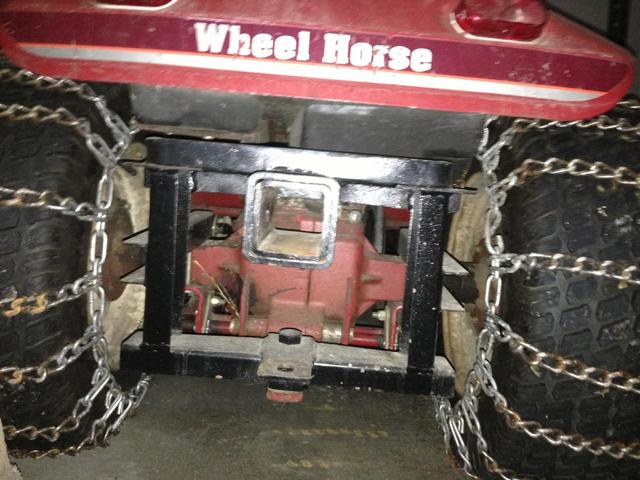

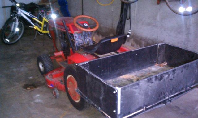

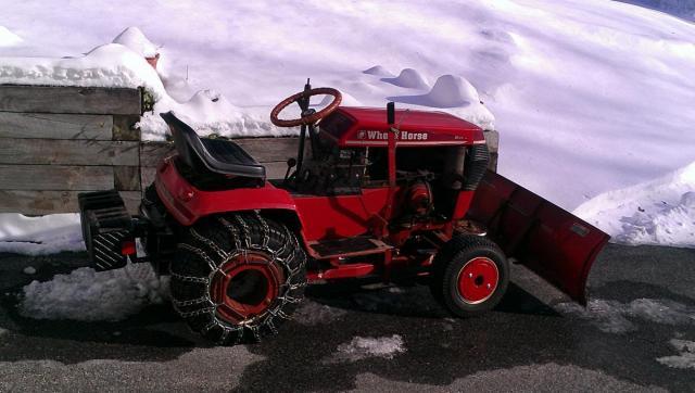

Tim 97 #21 Posted January 24, 2013 kevin i had an old bracket that was for a rear trac vac, I welded a 2" receiver to it I bought a trailer hitch and cut off the part where the ball bolts on I then welded a piece of flat stock to it to hold the weights and a couple pieces of flat stock to stop them from sliding out this works well for me, i took a cargo carrier that i made and made a box for it, i use the tractor like a little truck around the yard 2 Share this post Link to post Share on other sites
