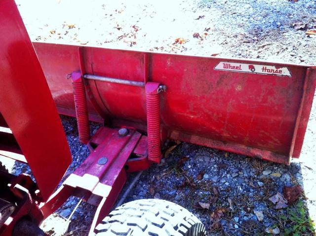

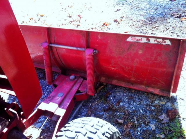

Eric_White 7 #1 Posted January 17, 2013 I've tried using my Wheel Horse with the 42" plow on it for snow removal, it works very well except every so often I find it not pushing much snow or digging in the ground. Does anyone know WHERE the skid shoes were located on these plows? Thanks Guys...Eric Share this post Link to post Share on other sites
TT-(Moderator) 1,162 #2 Posted January 17, 2013 Skids were not an option on those blades. If you want skids, you'll need to build and install them yourself. If the ground isn't froze, there will always be peeling. You can decrease the aggressiveness by tilting the blade forward at the top. Remove one of the hitch pin clips from the rod that's installed through the top of the trip springs, remove the rod, tilt the blade forward at the top, and reinsert the rod through a "lower" set of holes. 1 1 Share this post Link to post Share on other sites
Eric_White 7 #3 Posted January 17, 2013 Sorry, not understanding how changing the blade angle will keep the plow from digging and I do mean diggin into the ground and not getting and snow in some spots. there are elevation changes of more than an inch or 2 in my driveway, I mean it will stop me dead in my tracks digging in...I feel that this would be better if it would ride on something that skims the ground. Share this post Link to post Share on other sites
TT-(Moderator) 1,162 #4 Posted January 17, 2013 Compare the cutting edge (wear bar) of the dozer blade to a knife blade....... If you tilt it back at the top edge, it will cut in when you push it along a surface. If you hold it 90 degrees to the same surface, it will just scrape over the surface. That's why there are multiple holes in the dozer blade. If your driveway is not flat and smooth, you won't be able to get it perfectly clean. :confusion-shrug: Share this post Link to post Share on other sites

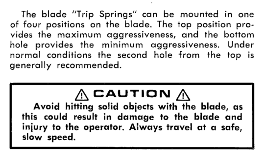

varosd 1,185 #5 Posted January 17, 2013 like Terry said, you can adjust the angle of the blade. I tried to cut and paste out of the online Snowblade operating manual but not working! 1 Share this post Link to post Share on other sites
TT-(Moderator) 1,162 #6 Posted January 18, 2013 'Clipped' from the manual: Share this post Link to post Share on other sites
Foozerush 40 #7 Posted January 18, 2013 Like TT said move the pin in the springs on the blade it will make a difference.... Mine was the opposite of what yours was doing and sorta floating on the snow at times, moved it up and it worked a lot better the next time. Besides it doesn't cost anything to give it a try. Good luck. Share this post Link to post Share on other sites
Tankman 3,523 #8 Posted January 18, 2013 Tilt the blade as excellently described above by Terry. Thanks Terry. If you really want skids on the blade, you could mount them on the outside wear bar carriage bolts. "The skids on each side of the blade must be adjusted before operation.This is accomplished by loosening the set screws, adjusting to the desired position, and tightening again. The purpose of the skids is to keep the blade from catching on cracks in the walk or drive, and to allow it to float over uneven surfaces.(This dozer is equipped with a spring trip device. If the blade should strike a solid object it will tilt forward and slide over without jarring the operator.)" Something I've been thinking of myself. My 48" blade has the skids, works great. My 42" blade doesn't and never did, have the skids. Some early blades did have round disks (skids). Here's a link to what the skids (flat style) look like. My drive is gravel, I like the skids! http://www.partstree...-71380016-00016 Here's the round style (pricey!). http://www.partstree...-71380015-00015 Share this post Link to post Share on other sites

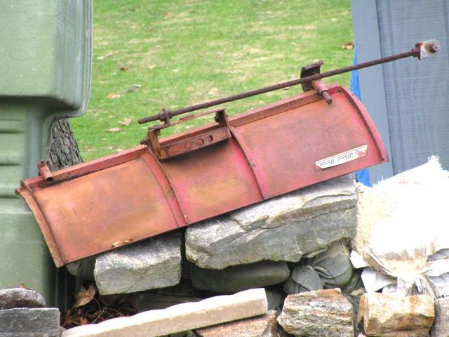

sorekiwi 761 #9 Posted January 18, 2013 This is what the big D series blade uses for skids: Share this post Link to post Share on other sites
Tankman 3,523 #10 Posted January 18, 2013 This is what the big D series blade uses for skids: Is that a 54" blade? Haven't seen a blade with four trip springs before. My 48" and 42" blades have two springs on each. Share this post Link to post Share on other sites
sorekiwi 761 #11 Posted January 18, 2013 Is that a 54" blade? Haven't seen a blade with four trip springs before. My 48" and 42" blades have two springs on each. It was 54 or 56. Its not here anymore, so I cant measure it for you. Share this post Link to post Share on other sites
Tankman 3,523 #12 Posted January 18, 2013 Is that a 54" blade? Haven't seen a blade with four trip springs before. My 48" and 42" blades have two springs on each. It was 54 or 56. Its not here anymore, so I cant measure it for you. Looks like the blade would take quite a smack to trip four springs. The "nose" of the frame appears a little "pointier" than other dozers I've seen. I'm wondering if the angle quadrant is the 5-hole style? Keepin' my eye open for a 54" blade, think I know where one is. Might go take a peek-a-boo. :) Share this post Link to post Share on other sites
Kelly 1,033 #13 Posted January 18, 2013 The D blades are taller also, see how short the springs are compared to the blade. Share this post Link to post Share on other sites
Tankman 3,523 #14 Posted January 18, 2013 The D blades are taller also, see how short the springs are compared to the blade. Thanks for pointing that out. Interesting. I saw a 54" blade advertised but image doesn't show four (4) springs. Share this post Link to post Share on other sites
