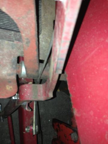

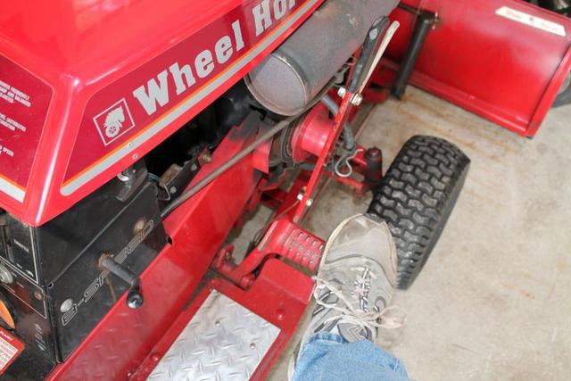

Tim 97 #6 Posted January 16, 2013 i had the same issue with a 314-8 it was hitting the part of the pedal that the rod is connected to i put a few washers between the lever and the plow frame and it now clears it Share this post Link to post Share on other sites

Tim 97 #9 Posted January 17, 2013 I believe the notch in the handle goes towards the footrest. Making the bend to the outside. I have it this way one my 520. Jeremy I bought the plow new and the handle was set up that way and i never questioned it. if I did flip it around,then then it looks like the notch would hit my the end of the footrest , giving me even a bigger problem. take another look at the top two pics, you'll see what i mean. it would make more sense, what is the purpose of the notch.. Share this post Link to post Share on other sites

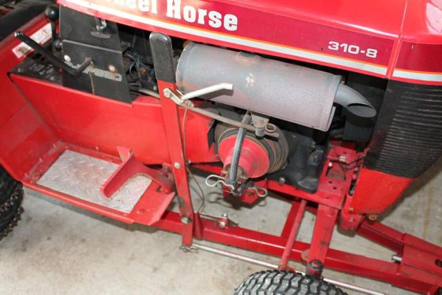

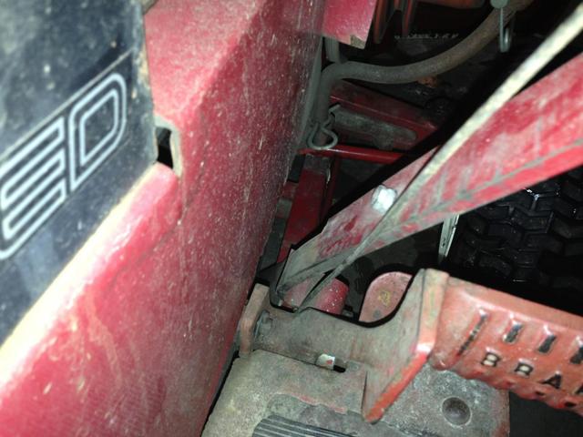

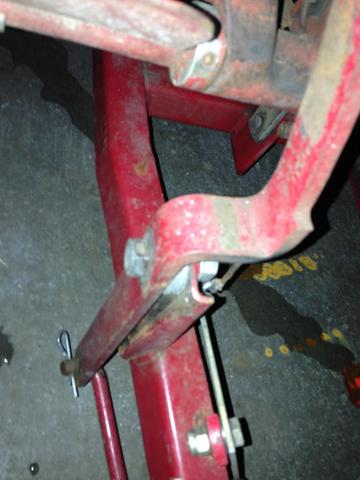

C100 0 #11 Posted January 22, 2013 Here are my brake/plow angle pics. Share this post Link to post Share on other sites
doc724 925 #12 Posted January 23, 2013 I had a 314-8 that I sold last year. The plow I used was one I bought when I had a late 70's C series. On the 314-8, the pivoting lever did in fact hit the muffler when you pushed the lever forward (pivot left). I never had any problem getting the locking pin to engage though. I don't recall any problems hitting the brake when pivoting right. I had the pivot handle exactly thae same direction as poster Tim, however, I did NOT have any washers between the handle and the plow frame. Hope this helps. P.S. is the rear support centered on the rear axle (side to side)? Was the "A" frame sprung, meaning damaged so it does not sit properly with respect to the tractor? Share this post Link to post Share on other sites
sorekiwi 761 #13 Posted January 23, 2013 Just a guess here, but if you turned your lever around the other way (and switched the cable lever around to suit) then the portion of the lever above the pivot would point slightly forwards instead of slightly backward. That may give you clearance on your brake pedal (and hopefully not create a problem with it going to far forward and into the PTO). Share this post Link to post Share on other sites

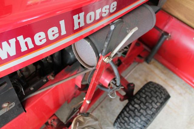

varosd 1,185 #14 Posted January 23, 2013 looks like you don't have any bend at all by the picture here is a picture of my mid 80's blade see the "bend" inwards for 8-speeds and if you have Auto, you just flip it around. I'm sure you could try to bend it in order to clear the pedal but might then not angle correct as it still has to be attached at the bottom to angle. Share this post Link to post Share on other sites
doc724 925 #15 Posted January 24, 2013 I think we have diagnosed the problem. That handle does not go with that plow on a 300 series tractor. Best to go shop around for the proper handle. Partstree can probably sell you a new one. At least you can get the correct P/N there. There is a bone yard in PA that likely has a used one. Good hunting Share this post Link to post Share on other sites
