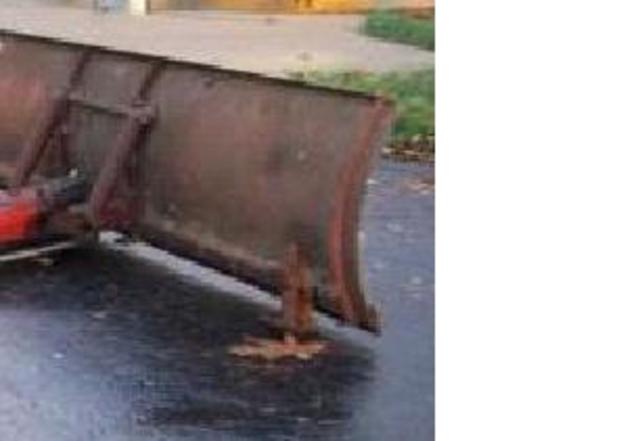

855ownerJoel 32 #3 Posted January 16, 2013 If your main problem is the constant liftin what about mounting some skid plates on your plow to make it ride just a little off the ground. These are used on pickup truck plows all the time for gravel lots. (Larger size skid plate on truck of course) Here is a picture, not mine, but gives you an idea of what I am talking about. Share this post Link to post Share on other sites
