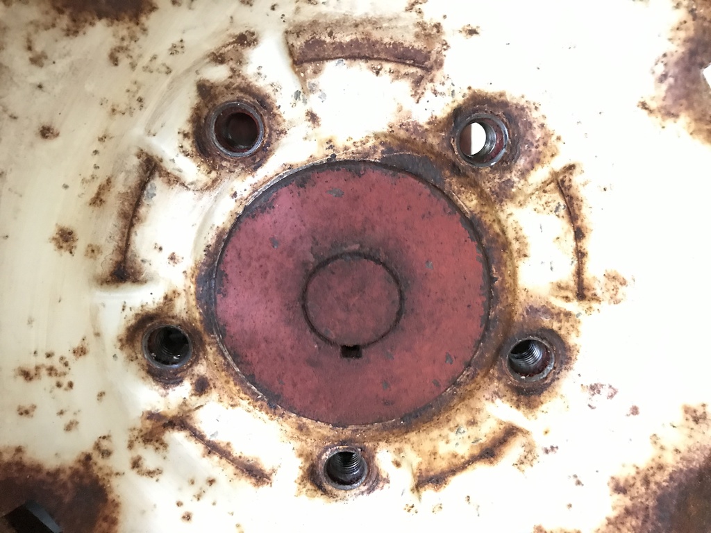

Kevbo 81 #1 Posted January 12, 2013 So here is where I'm stuck...and so is the rear wheel...looking at the picture below you will see that the wheel is rusted to the spindle and the spindle won't come off the other side if the axle. Any tricks of recommendations to get this off the transmission? Share this post Link to post Share on other sites

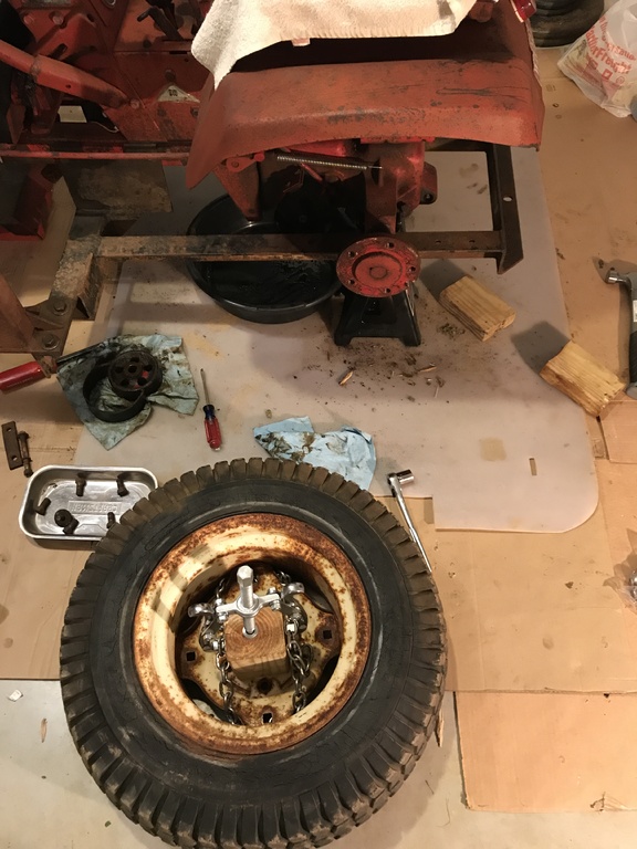

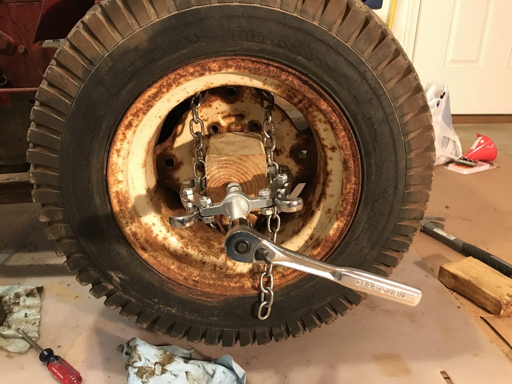

mra132 1 #20 Posted May 28, 2017 I realize this is an older thread but this weekend I had the exact same problem with my rear wheels being stuck on the hubs, and had been searching these forums to a solution that worked for my setup. Of course the hubs were stuck on the axles, so I couldn't just easily slide them off. I continually soaked them with PB Blaster for 2 days trying to break them loose but that didn't help. What finally did work was using a 2-jaw puller, chains, and a 4x4. I weaved the chains through the wheel slots to create 2 "loops" that I could attach the jaws to. Then, because I didn't want to add the center pin pressure directly to the axle (for fear that I'd be forcing the hubs off as well), I used a short piece of 4x4 that I had to distribute the pressure to the circular part of the hub. This got me 95% of the way there, then a little love tap with my hand on the back of the tire and they popped off. 1 Share this post Link to post Share on other sites
