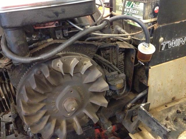

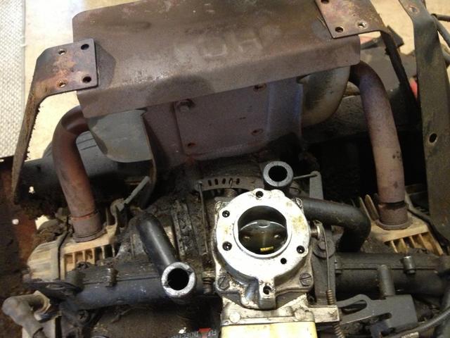

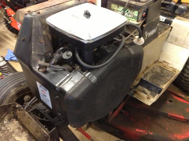

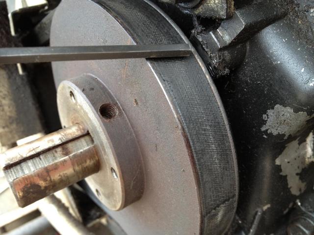

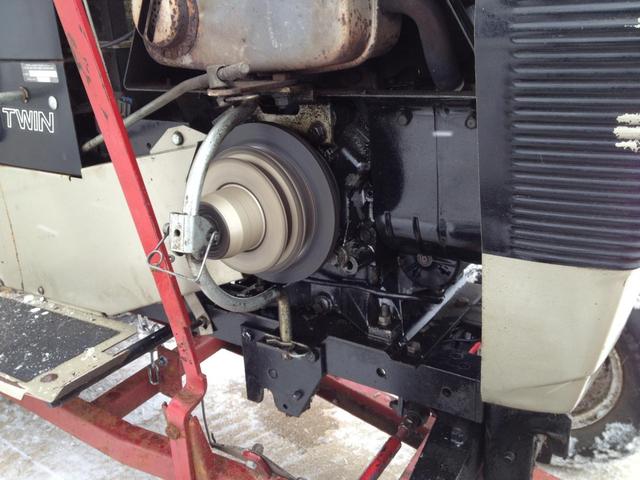

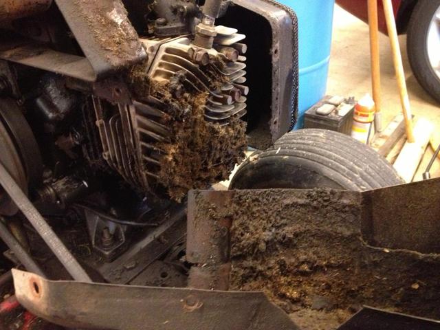

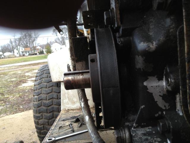

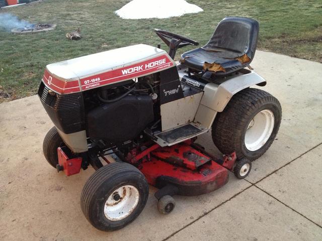

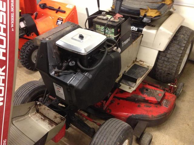

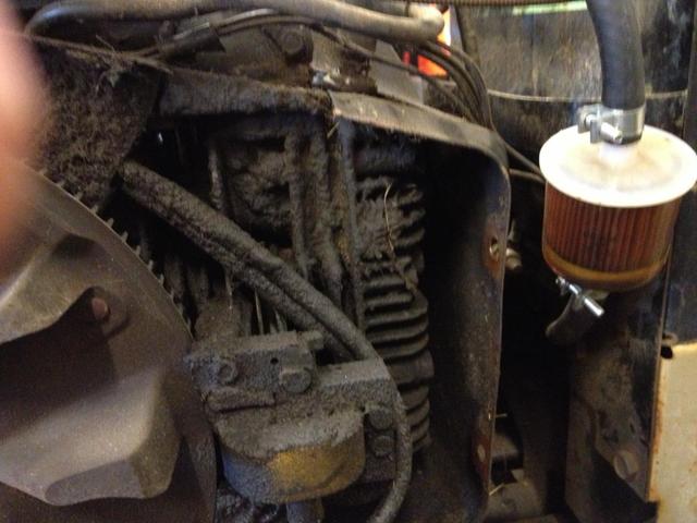

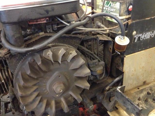

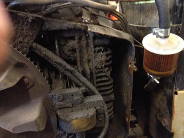

Martin 2,134 #30 Posted January 12, 2013 i spent some time today pulling the shrouds and cleaning all the crap out of the engine to make sure its getting plenty of airflow. also loosened off the muffler to see if there was anything loose in there. like was mentioned in a previous post it was loose and making noise similar to what i heard with the engine running.... also got it running much better, adjusted the high and low on the carb, (was running too lean-which would explain the choke needing to be out). heres some pics... front cylinder shrouding removed, lots of crap in here.... flywheel shrouding removed, the inside of the shroud had a bunch of grass and dirt/oil etc caked around it... back cylinder shroud was hard to remove so i cleaned it in place just moving it around to make sure i got everything out of the fins and shroud.... removed screws holding the back of the muffler to check for a loose baffle, one thread nut stripped inside the muffler so i couldn't get it off completely, still it was loose enough to confirm there was a loose baffle inside. the second pic is a video of me shaking it..... also while i was looking around the engine i noticed the drive pulley was rubbing against the side of the engine, the set screws had allowed it to move, so i loosened them off a little and moved the pulley out some. this gap here was non existent. engine all back together looking a little cleaner....... Share this post Link to post Share on other sites

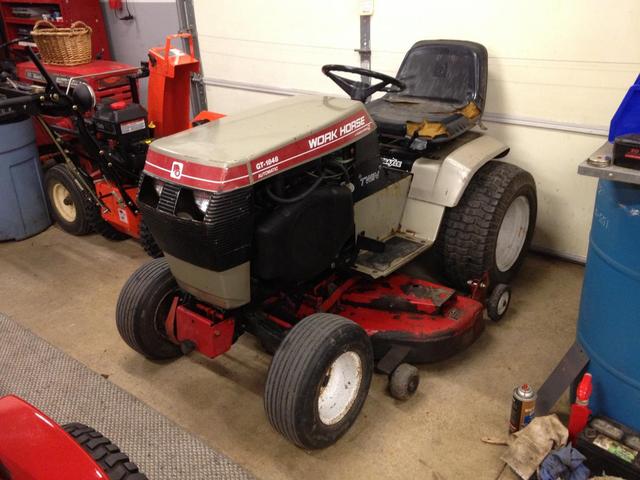

Martin 2,134 #31 Posted January 12, 2013 im happy with how it runs now, rode it around for 30 min or so to see what the hydro was like, seems real strong. another video.... Share this post Link to post Share on other sites

gwest_ca-(File Mod) 12,511 #33 Posted January 12, 2013 You may need to add a spacer behind the drive pulley because the set screws can't take the pressure when the pto clutch is applied so the pulley moves in. Garry Share this post Link to post Share on other sites

bowtiebutler956 650 #36 Posted January 13, 2013 Wow, some of the fins were plugged solid with crud! Its amazing it hadn't seriously overheated and died! Nice work Matin. I bet its about 20lbs lighter, and 20 degrees cooler now! Matt :flags-texas: Share this post Link to post Share on other sites

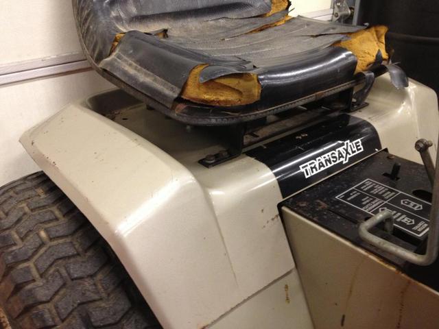

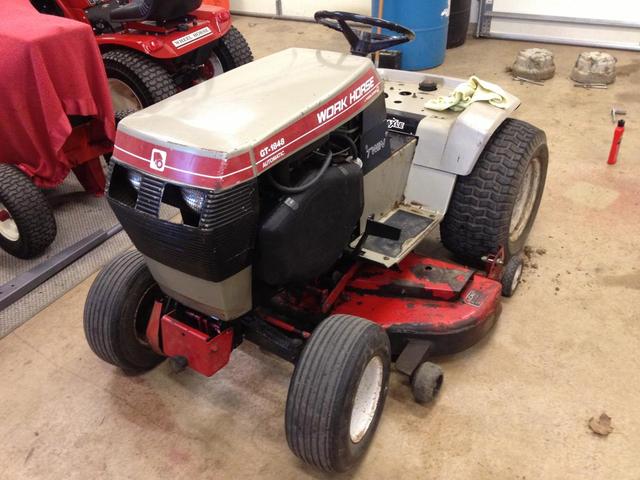

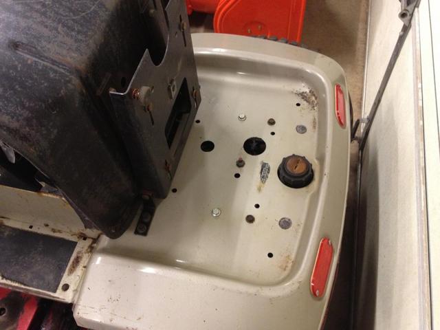

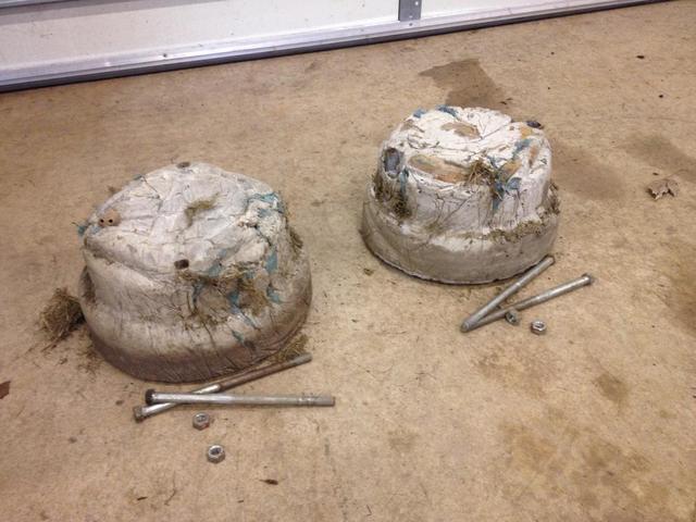

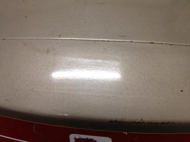

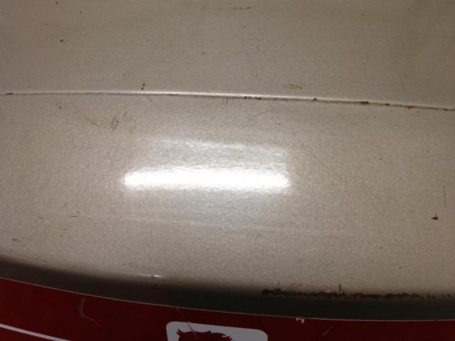

Martin 2,134 #37 Posted January 20, 2013 (edited) did some more on the gt today, got it cleaned up more. did a couple runs with degreaser and wash down, got it much cleaner. pulled the seat pan and cleaned up underneath around the hydro and blew air into every area i could find to remove grass and other crap. the more i clean the more i find....... straightened up the seat pan, cleaned up the paint and got it looking better, still needs some more work but its better. also pulled the rear weights to clean up the wheels.... interesting looking concrete weights..... heres some pics. just realized i uploaded a bunch of pics there, no complaining about too many pics!! gonna need a seat soon too....... Edited January 20, 2013 by Martin Share this post Link to post Share on other sites
Wheel-N-It 2,978 #38 Posted January 20, 2013 It looks like a different tractor now Martin! Runs much better now too. Good work I can see now I'm gonna have to try and find one too. Share this post Link to post Share on other sites

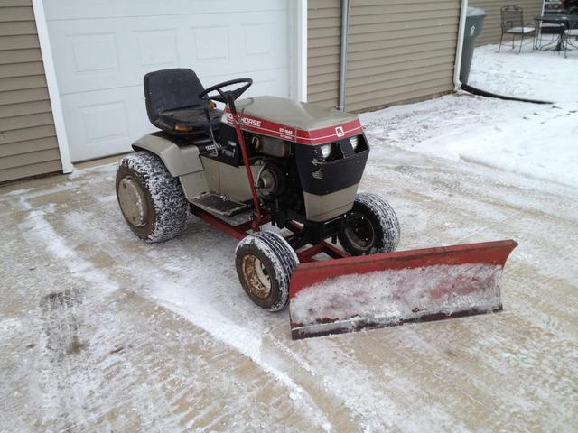

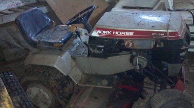

Martin 2,134 #46 Posted February 2, 2013 (edited) just got in from plowing the small amount of snow we got last night. it was about an inch but because of drifting, i had some more in other areas to play in...... plowed all our driveways and did the sidewalks in our street. was out there for about 2 hours and had it running the whole time. got the engine and hydro nice and hot, drives great, everything works as it should, smooth!!!! have an oil leak from the pto side of the engine, not excessive, no change in oil level, but after 2 hours of running theres a mess all over that side of the tractor. will have to take a look at that soon..... this thing is great for snow duty, forward and reverse are fast, hyd lift works great, took me a little while to get used to driving and operating the plow at the same time, but the hyd lift is so much easier than the manual that i used in the past, and im not worn out afterwards, or have put my shoulder out. wasnt much depth in the snow, but no ice out and never lost traction. i have some chains that came with my c160 but i think they are for 23 x 8.50 and not sure if they will work on the 10.50s, id rather not use chains anyway..... reinstalled the concrete weights and it was good like that on the turfs. those weights are considerably heavier than the iron weights i have, so i figured just use them as they came with it. heres a pic after the fun...... and heres the side of the engine, damp from the leak, not excessive, but i need to take a look at it some time...... Edited February 2, 2013 by Martin 1 Share this post Link to post Share on other sites

steve k 82 #48 Posted February 2, 2013 (edited) Thats a lot of tractor! Nice! I put a chain for the plow link instead of the steel bar, It allows the blade to "float" out in the grass, but still scrapes clean good.......my .02 Never mind.....it looks like thats what yours has also.... :hide: Edited February 2, 2013 by steve k Share this post Link to post Share on other sites
Wheel-N-It 2,978 #49 Posted February 3, 2013 I'm glad to hear you got to play in the Snow with your new horse. If the crank seal is leaking Martin, I think LUCAS makes a product that will recondition engine seals to stop leaks such as yours. Share this post Link to post Share on other sites
