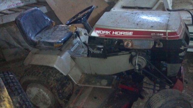

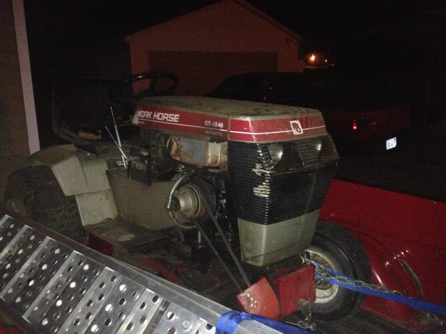

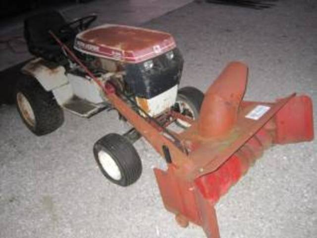

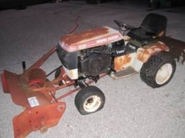

anyway here is 2 pics, first is from the ad, the second on my truck when i got home, not real good ones but better than nothing. more will come when i get it off the truck, but i though you guys would let me off tonight with just these.......
tractors in reasonably good cosmetic condition, not real clean, it spent its time in a covered barn when not being used, but its got a bunch of crap all over it and doesnt look like it was cleaned very regularly after mowing.
not sure of the year though......

Looks very nice martin! Can't wait to see when you get to messing with it! ~Jake

I'm not saying you're wrong, but I can't see Toro/Wheel Horse bowing to the pressure of a single John Deere/Wheel Horse dealer. I think the Work Horse line was just a marketing tool to compete with lower priced units in a market that was changing.
By the way Martin, nice find. The GT-1848 was either an A1-184801, 1982, or a D1-184801, 1983.

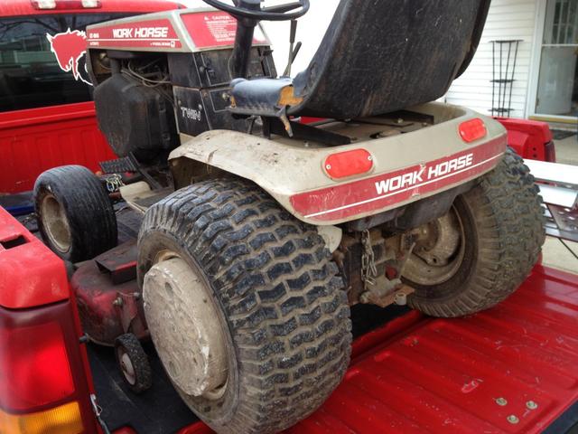

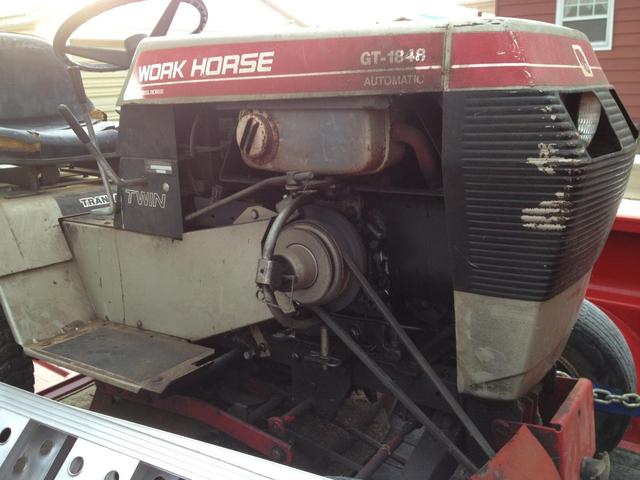

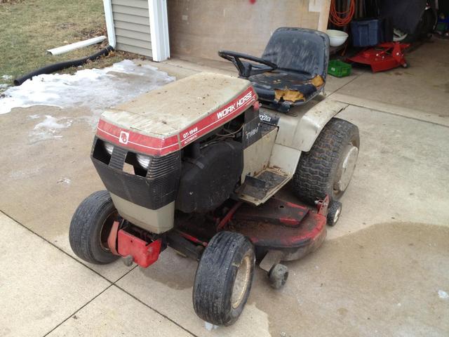

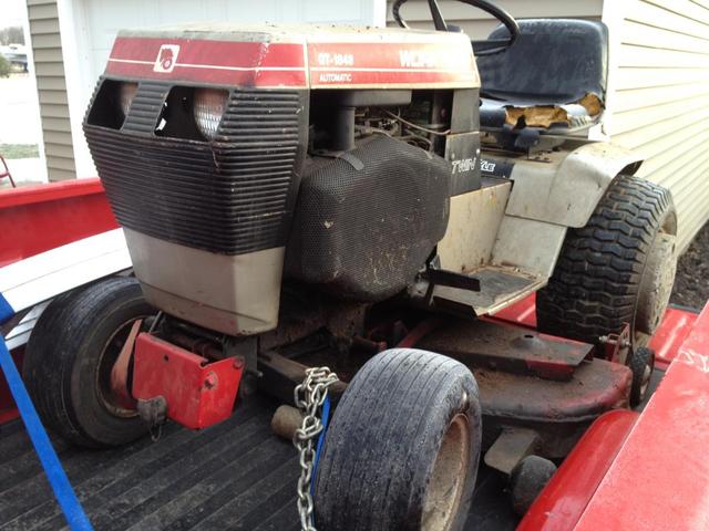

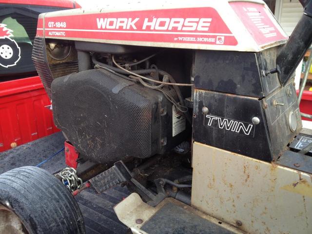

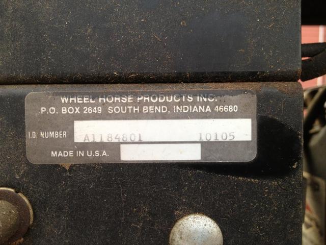

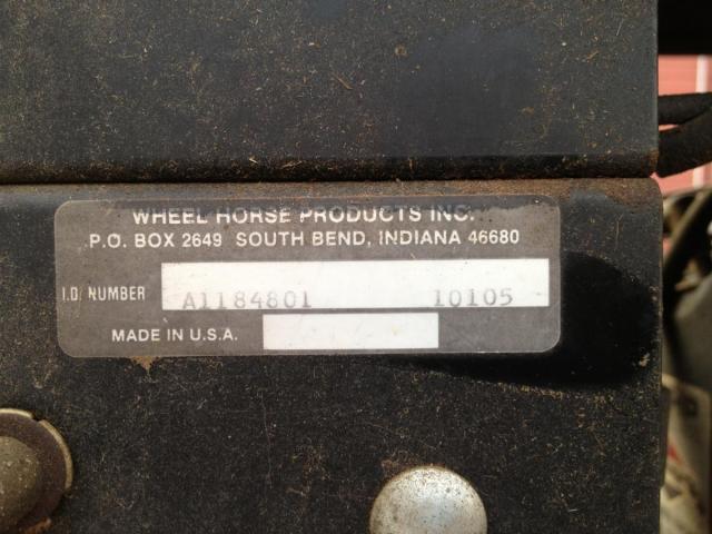

im doing a little research to try and work out what year this is. the id tag on these things isnt like the earlier stuff and so im trying to decipher it.... a little help might go a long way....
i cant find any number on the engine as yet, maybe after a clean it will be easier to find.....
heres some more pics of it on the truck, check out the home made wheel weights!!!!!

alright i think i found what i was looking for.......
this post......
had what i needed, i guess with the id number all together with no spaces confused me but it breaks up and now ive got it........
:scratchead: Back again with some questions regarding the differences between a GT-1848 Work Horse and a GT-1800, what are the differences? TT id'ed this thing for me but i don't know what parts to get for it , i am in the process of tearing it completely apart, getting a new lift and controls, PTO, seat, fenders, and engine and will spend some time painting and i'll be ready to go.
1982 A1-1848 01 GT 1848
1983 D1-1848 01 GT1848
1984 A1-1800 01 GT1800
my number is A1184801 10105 (A1 1848 01) so if im not mistaken its an 1982......

Your correct that you have an 1982. My recollection from when I did mine was that everything is the same as a red tractors except the engine and colors. I used a urethane to paint mine. I belive it's a Ford or Lincoln/Mercury color for the grey and white wheels. The only problems aside from needing a rebuild kit for the hydro control valve was I had to replace the coil. I would be out mowing and when the tractor started to heat up it would cut out and not start again until it cooled off. New coil and no problem. I allways worried about the B&S but it was a great engine. This was without a doubt one of the best tractors I ever owned. The 48 inch deck and snowplow worked great with the hydro trans and hydro lift. Wish I would have kept it.

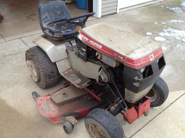

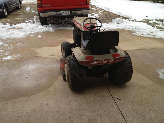

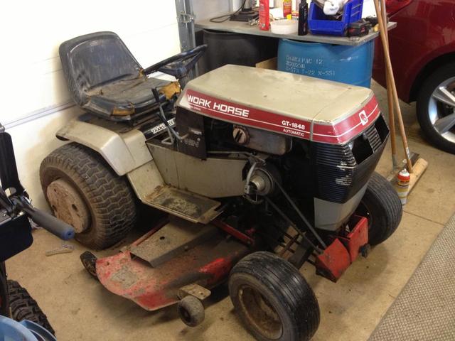

thanks guys, it runs ok. the fuel pump wasnt working and i couldn't get gas to flow so replaced fuel hoses as they were old and cracked, still more is needed as it wont run up high unless the choke is out. i will look at that sometime down the road as for now just wanted to see how it drove and check out the smoke issue and see how strong the hydro was.....
hydro is strong and nice and quiet, lift works well, no complaints there, the hydros are always a worry for me if i get one not thats not running. everything i come across lately isnt running, and while its a bargaining thing sometimes, its still a worry that maybe you just bought a bunch of parts that look like an assembled tractor. ok if you are only giving $50 for it, but when its in the hundreds then it does concern me. except for the c160 which i gave 300 for, this is my next most expensive non runner at 250. i think i did ok, im happy with how it drives, didnt test out the mower deck as the pto clutch is bad, the seller told me the lining was worn out, so i will look at that later.
the engine is noisy in the lower rpms, seems ok up high but a bit too noisy for me at idle and when starting and shutting down. i will post a video and see if any ideas come up. it runs strong and has a bunch of power. i think im going to let it sit for some time, might get it running better in the summer and mow with it this season.
heres some pics and a video or two will follow.....
post-4321-0-56686200-1357841388_thumb.jp
post-4321-0-77608600-1357841407_thumb.jp
post-4321-0-14870200-1357841428_thumb.jp

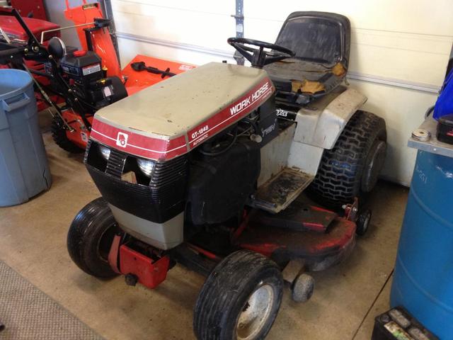

gave it a good blow down with air, got in all the known areas, still need to pull the tins and check out the fins on the engine. gave the hood a pb blaster polish.....
post-4321-0-93202100-1357841443_thumb.jp
garage is getting a little crowded......
