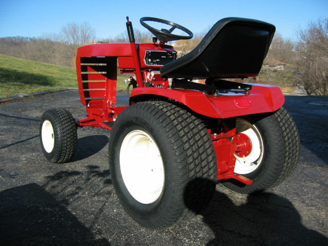

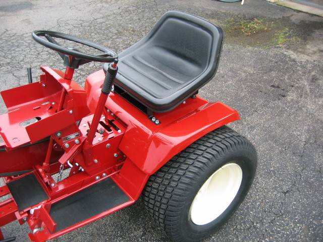

Wishin4a416 2,473 #77 Posted November 16, 2013 Got the Safety switches on today along with the clutch spring, NOS on ebay for 5 bucks, and the seat. I picked a seat up on ebay for 20. Not a WH seat but looks alot like one. Had to pull the cover and reconfigure the mounting holes but I think it looks OK. Got started on the Hood today but that is going to take awhile. What a beautiful Fall day here in Pa. for working in the Garage. 2 Share this post Link to post Share on other sites

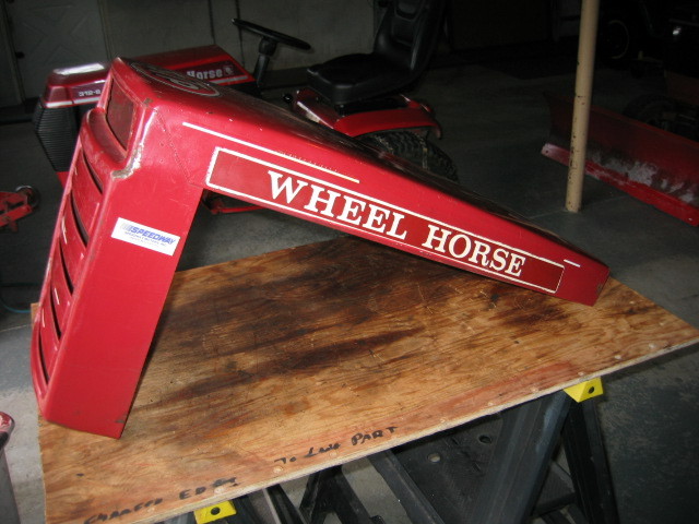

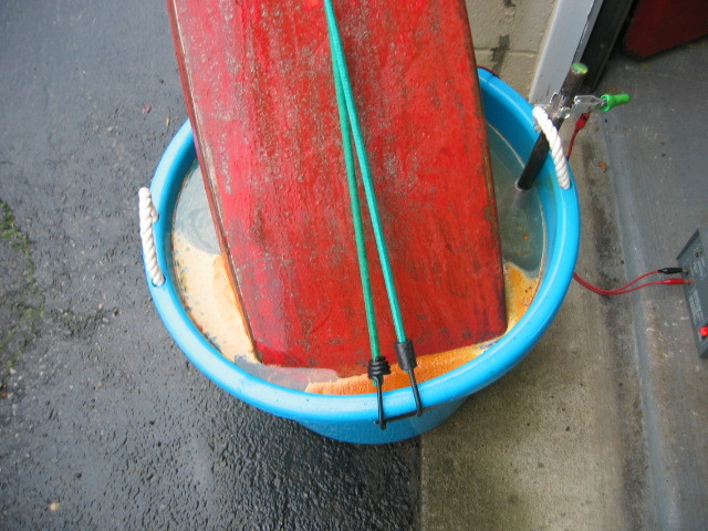

Wishin4a416 2,473 #78 Posted November 17, 2013 Hoods in the cookpot now. 3 Share this post Link to post Share on other sites

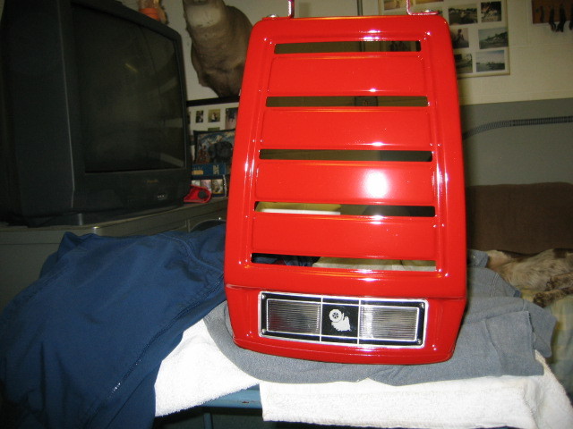

Wishin4a416 2,473 #79 Posted December 22, 2013 Finally got the Hood done and ready to go back on. I have a few days off after Christmas and hope to get some work done on it. But according to the weatherman the garage is gonna be cold. 1 Share this post Link to post Share on other sites
timo4352 148 #80 Posted December 22, 2013 Your paint work is really something. She gonna be a real beauty when your done. Share this post Link to post Share on other sites
dodgemike 52 #81 Posted December 23, 2013 Absolutely stunning paint work. I am meeting more and more Members who were or still are Into musclecars. Sent from my SCH-S720C using Tapatalk 2 Share this post Link to post Share on other sites

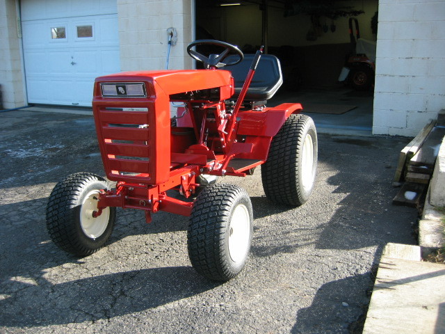

Wishin4a416 2,473 #82 Posted December 28, 2013 Well its been a year to the day since I brought it home from Ohio. It took me that long to get this far but it has been fun and a learning process from a bunch of you fellows here. Thanks for all the tips and pointers. The tractor is 98% done. Now its time to open the Kohler up. It ran when I removed it. Just a bunch of oil leaks everywhere. If everything works out, this one will wear the snowblower. 2 Share this post Link to post Share on other sites

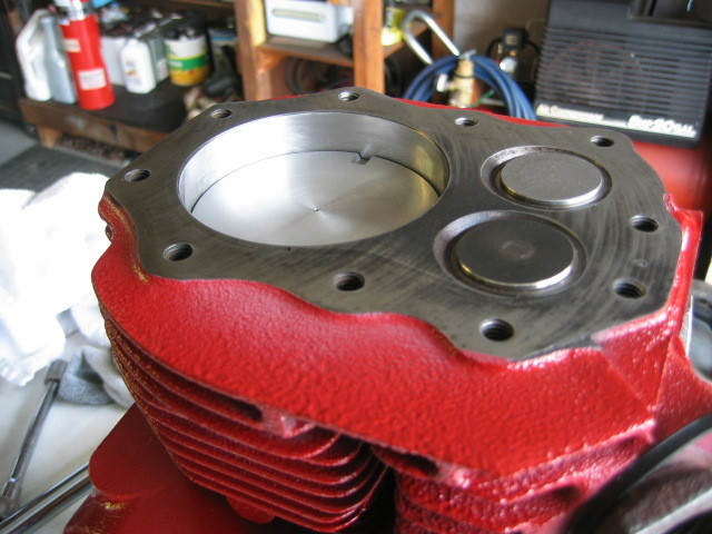

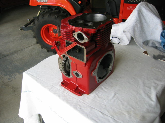

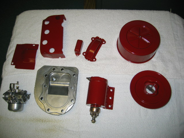

Wishin4a416 2,473 #83 Posted January 25, 2014 Got around to starting on the Kohler this past week or so. My garage is so cold with this brutal Winter, I hate to even go out there and pull parts. I got the carb all cleaned and bushed and the head decarboned and checked for flatness. There were 2 loose headbolts and it shows with a blown head gasket.The bore checks out standard and within specs @ .751-.752 and .001 out of round and taper. A small carbon ridge near the valves to ream before Honing. I got a few more parts off this morning to take to work to degrease and blast and paint this week. Calling for 15 below here Monday nite!!!! And a high of 2 Tuesday. Share this post Link to post Share on other sites

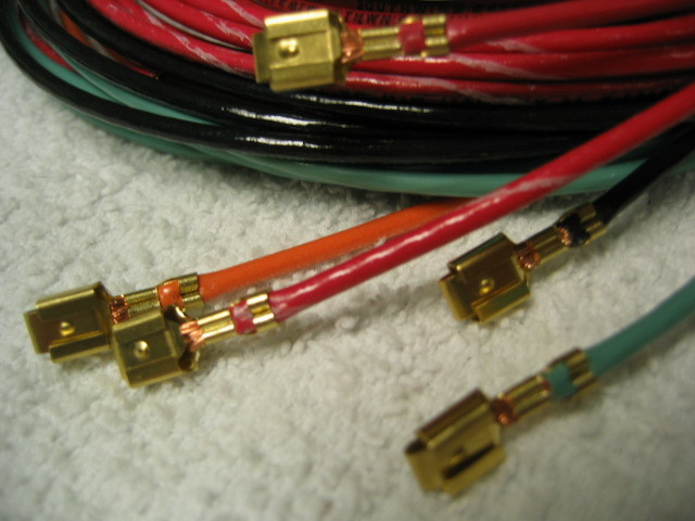

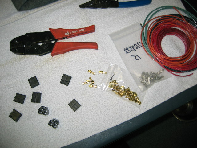

Wishin4a416 2,473 #84 Posted February 8, 2014 Got some goodies in the mail this week so I started on the Wiring Harness. Its just so dern cold in the garage right now, cant do much else. It was -1 here this morning. I messed the first couple crimps up before I got knack for it. Seems you could use 3 hands positioning everything. Im ready for Spring. 3 Share this post Link to post Share on other sites
Martin 2,133 #85 Posted February 8, 2014 Tractor looks really nice Jack. Nice to see some wiring harness fabrication from scratch as well...... Its nice to get all new terminals, connectors and wiring and start from nothing. Its still one of my favorite things to do when rebuilding these red tractors...... I'm with you on the crimping of terminals too, sometimes not quite enough finesse and there goes another one....... 1 Share this post Link to post Share on other sites
312Hydro 474 #86 Posted February 8, 2014 That's just super work ,Jack. I'll have to echo what the others have said as the detailing is really nice. :thumbs: Share this post Link to post Share on other sites
shorts 182 #87 Posted February 9, 2014 You got to love seeing someone take the time and effort to buy the right tools and parts to do the job right, especially like the proper crimpers for the terminals being used instead of what's n the tool box Share this post Link to post Share on other sites
Wishin4a416 2,473 #88 Posted February 9, 2014 You got to love seeing someone take the time and effort to buy the right tools and parts to do the job right, especially like the proper crimpers for the terminals being used instead of what's n the tool box Well I must admit the crimpers are borrowed. I asked the electricians and Bio-med guys at work and they had none. So I stopped at my auto mechanics garage who I have known since childhood and he had them in one of his toolchests. He had them since he worked at Yenko Chevrolet many many years ago. He said he hardly uses them at all any more. 1 Share this post Link to post Share on other sites

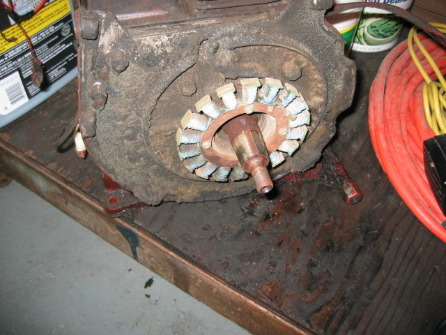

Wishin4a416 2,473 #92 Posted March 1, 2014 Got that stubborn Flywheel off today. I tried last Saturday but it wouldn't cooperate. So I kept brushing on red cider vinegar around the crank and wheel to break down the rust. I heated it with a heatgun and hit it with the impact gun and it popped today. It is filthy though and needs a good cleaning. 1 Share this post Link to post Share on other sites

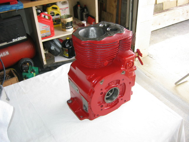

Wishin4a416 2,473 #93 Posted April 21, 2014 Finally got the motor block all prepped. Degreased and honed and valves lapped in. Now to start putting back together between grass cutting and the other springtime chores. 3 Share this post Link to post Share on other sites

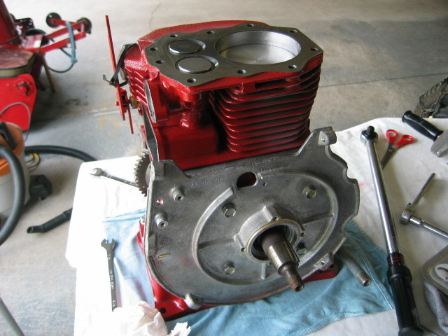

Wishin4a416 2,473 #100 Posted April 26, 2014 To wet to mow today so I got some garage time. Got the short block together and all the numbers were good. I see what Bob means about them pesky keepers. They were easier on a Chevy because they were headed down hill !! I got my forceps off my fishin vest and it made life a lot easier. 1 Share this post Link to post Share on other sites
