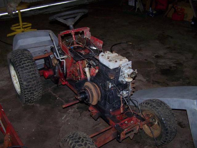

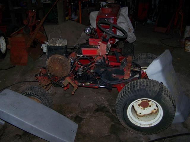

Wishin4a416 2,192 #38 Posted March 3, 2013 Finally got it all the way down even though the pic shows the transaxle still on. Gonna powerwash the frame and then blast it and then the tranny off to the parts cleaner at work for a good cleaning and flush. 1 Share this post Link to post Share on other sites
