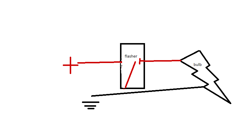

Cole 25 #8 Posted January 7, 2013 Try an experiment, find and LED bulb like you have, you can find them on ebay or at radio shack for under 20 bucks, and hook it up to a turn signal flasher like the one laying in the top of your tool box, you know how when you have a burnt out turn signal on your vehicle, lets say the driver rear, well then the driver front will flash much faster than normal, kinda like it's had too many cups of coffee, probably 2-3 flashes per sec. because of less power draw or more power, in your case, that's the rate your looking for. all I'm saying is that you need to find an bright LED and a turn signal flasher and test em out, but before you spend some money, try hooking straight up to the power source like duke said. Share this post Link to post Share on other sites
