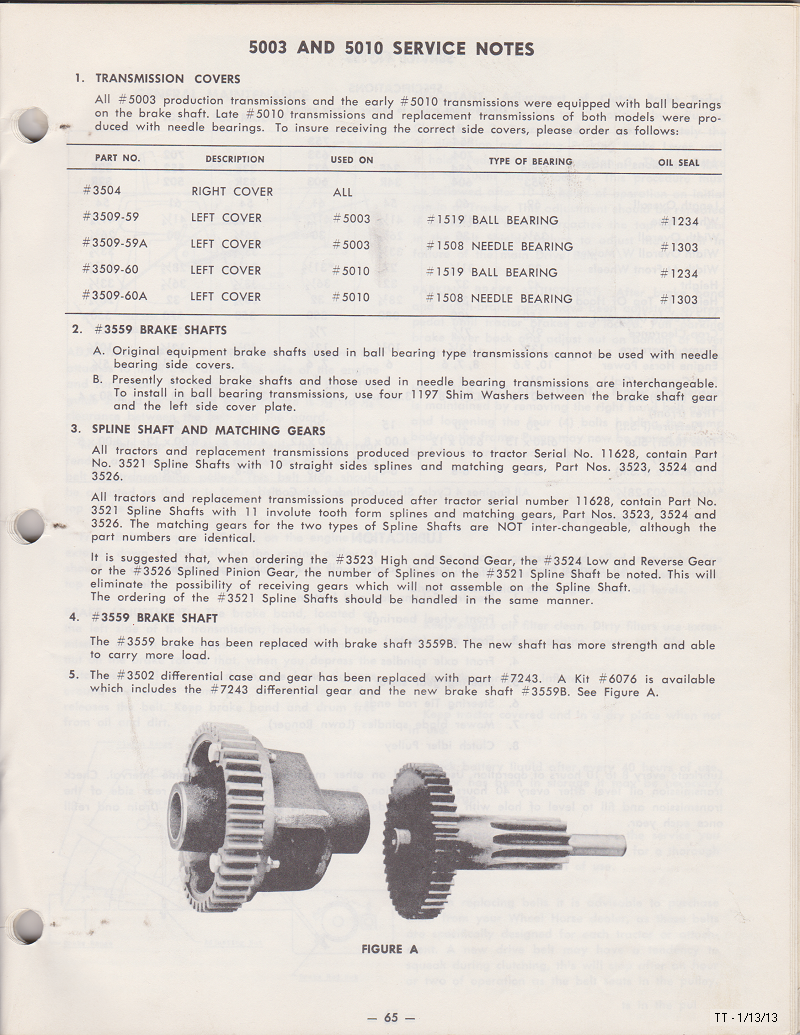

buckrancher 2,697 #33 Posted January 13, 2013 Also, that is not the #3502 differential...#3502 is the number for the older style...about 33 teeth. Steve where are you getting that information my owners manual for 701,401 551 shows transmission #5010 used on a 401 as diff.case and gear as part #3502 ? Brian Brian, check on page 12 of this manual link (service notes)...it is a little confusing, and I am not positive about the part numbers, but there is a difference between the early and later differential housings and brake shaft gears. Here are 2 videos of the 3 differentials that I have seen that go into the #5003 and #5010 transmissions. Maybe they kept the same part number and just used the replacement gears. http://www.mywheelho...ns/492-4004.pdf Steve check page 14 you will see the part # is 3502 with note 5 the way I read this is: part #3502 with the course teeth is the first version part #7243 with fine teeth is the second version (part upgrade new rev. level) part #7243 up graded to a two piece diff hub and hard gear (final upgrade third version) after first version brake shaft was upgraded to fine tooth( new rev. level to match diff. gear) brake shaft will work with the two later versions (fine tooth) Brian 1 Share this post Link to post Share on other sites
TT-(Moderator) 1,187 #34 Posted January 13, 2013 The revised brake shaft is p/n 3559B. The service kit containing #7243 differential gear and #3559B brake shaft was sold under part # 6076 1 Share this post Link to post Share on other sites
buckrancher 2,697 #35 Posted January 13, 2013 thanks terry good information :handgestures-thumbup: Share this post Link to post Share on other sites
TT-(Moderator) 1,187 #36 Posted January 13, 2013 No problem! I dug out the scanner, so here it is in print form: 1 Share this post Link to post Share on other sites
stevasaurus 23,890 #37 Posted January 13, 2013 Brian, That is the way I see it also. TT, thanks for the information...that PDF is the same as page 12 in the manual. I guess the point is that you have to have the right brake shaft gear to match the right bull gear. Mike, I think I may have an idea what is making your click in reverse only. See if this makes any since. The reverse idler is a wide gear...1/2 of it is always engaged with the cluster gear. When you shift into reverse, you engage the 1st and reverse fork gear with the other 1/2 of the reverse idler. If there is something wedged in that part of the reverse idler it would account for your click while in reverse only. What do ya think??? :) Share this post Link to post Share on other sites
