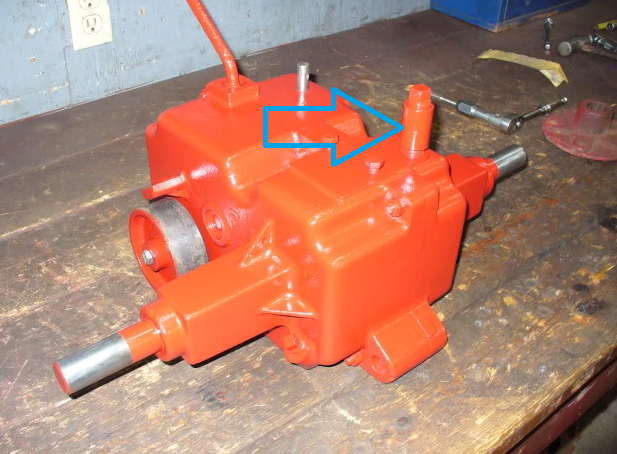

Kevbo 81 #1 Posted January 6, 2013 So on my B-80 tranny I have yet to find a dipstick or place to add tranny oil does it exist? As I continue to strip the tractor will I find it?? Thanks guys! Share this post Link to post Share on other sites
TT-(Moderator) 1,173 #2 Posted January 6, 2013 Regardless of what year B-80, the dipstick is installed at the top rear of the right tranz case. Representative photo to show general location: Share this post Link to post Share on other sites
855ownerJoel 32 #3 Posted January 6, 2013 Regardless of what year B-80, the dipstick in installed at the top rear of the right tranz case. Representative photo to show general location: Is that orange? Share this post Link to post Share on other sites
TT-(Moderator) 1,173 #4 Posted January 6, 2013 Is that orange? Krylon IHC red and a really bright camera flash. Is this better? Share this post Link to post Share on other sites

TT-(Moderator) 1,173 #6 Posted January 6, 2013 Oops... that's a 4 speed. I keep thinking yours is an 8 speed. Check & fill the oil at the plug on the lower left rear corner. Share this post Link to post Share on other sites
Kevbo 81 #7 Posted January 6, 2013 Is that the only place to fill and drain? Share this post Link to post Share on other sites
TT-(Moderator) 1,173 #8 Posted January 6, 2013 Fill & check. The drain is on the bottom. Share this post Link to post Share on other sites
