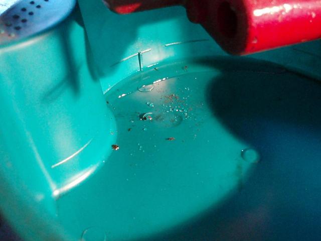

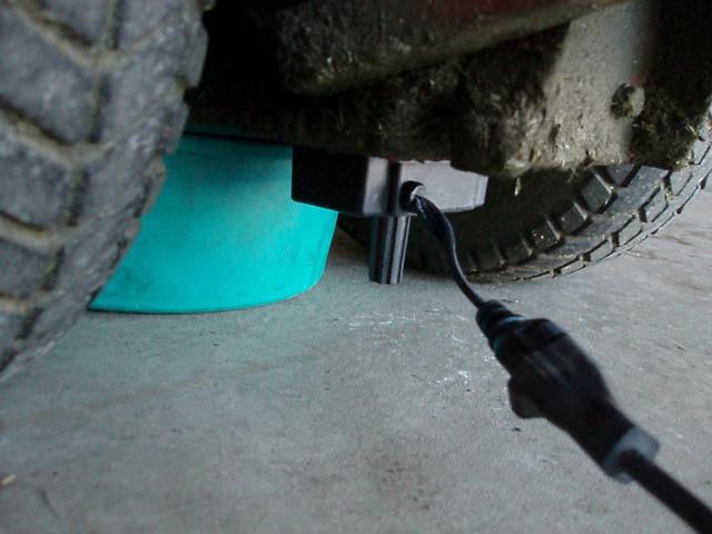

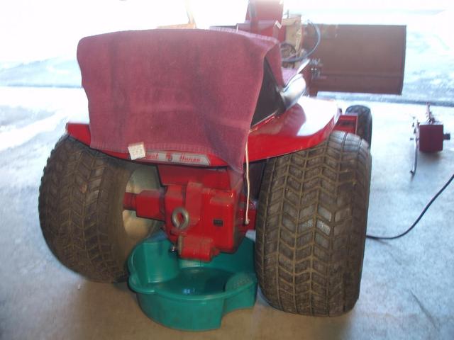

Terry M-(Moderator) 2,290 #1 Posted January 4, 2013 Started Tinkering today with my latest aquisition, a 1965 Lawn Ranger. When I bought this tractor a few weeks back , The weather was warm and everything seem good on this ranger. I pushed this tractor in the corner for a couple weeks and after our cold weather hit suddenly the Transmission is "locked up" My first thought was something is wrong with the internals of the trans. I also thought maybe its frozen. Well today I verified the second....a frozen transmission . One of the things I thought I'd do was warm up the garage , attatch a 200watt magnetic heater to the bottom of the trans. casing and drain and refill with some fresh lube. well , for about 30 minutes nothing came out...OK, it gets worse. Then slowly,but surely, water starts dripping out the drain hole. Last time I check just a few minutes ago there was about a quart or a little less of Nice clear water with a little oil mixed in. The water still dripping out last time I checked. I was going to use this ranger to play in the snow but I'm guessing that wouldn't be a good Idea for a while. Forgot to post some pics of the ranger when I got it home but here it is today. And i'm kicking myself for not checking the trans oil. The good part is I made and installed the missing linkage piece for the lawn ranger snow plow ,but it may be a while before I get to use it. Here are some pics of the tractor and the water just starting to drip from the transmission. 1 Share this post Link to post Share on other sites
Terry M-(Moderator) 2,290 #2 Posted January 4, 2013 Notice one pic shows the water starting to drip out, The farther away pic shows the pan starting to fill up with water. Share this post Link to post Share on other sites

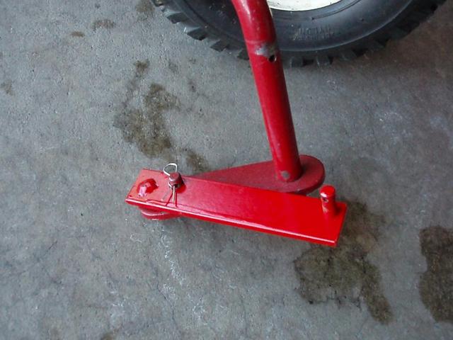

Terry M-(Moderator) 2,290 #6 Posted January 5, 2013 On another note, Here is a pic of the linkage piece I needed and made for the plow. Thanks Lane!! 1 Share this post Link to post Share on other sites

Lane Ranger 11,814 #12 Posted January 5, 2013 Terry: Lift piece looks great. Glad it will work for you. I will post a picture of one of my Lawn Rangers with the plow and you can just see the lift piece on it too! Share this post Link to post Share on other sites
Terry M-(Moderator) 2,290 #13 Posted January 5, 2013 Terry: Lift piece looks great. Glad it will work for you. I will post a picture of one of my Lawn Rangers with the plow and you can just see the lift piece on it too! Lane, Was I correct in how I made and installed it?? Share this post Link to post Share on other sites
Lane Ranger 11,814 #14 Posted January 5, 2013 I think you were so correct you should make a couple more and sell them! Looks ok to me on the set-up . Have you had it plowing any snow yet?? Share this post Link to post Share on other sites
