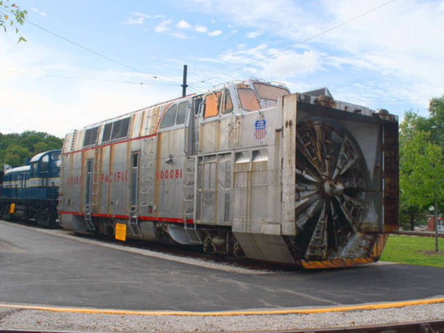

ol550 879 #10 Posted January 14, 2013 (edited) This is a retired snowblower, but it had 3000 hp. Kind of a special purpose though. IMG] Edited January 14, 2013 by ol550 1 Share this post Link to post Share on other sites

Wyattrrp 59 #12 Posted January 14, 2013 AND no Sitff Wire in front of the auger to stop the hand injury when reaching in to unclog it from wet heavy snow! Shame Shame. But.... I bet it did a good job of thorwing 8 ft drifts!! With that I would need more rear weights! Share this post Link to post Share on other sites
ol550 879 #13 Posted January 15, 2013 No tach a matic hookup. Would need extra weight to push it. Weighed in at 367,400 pounds and required 3 or 4 engines to push it 4-6 mph. The blower fan is 12 ft. :omg: Share this post Link to post Share on other sites
Wyattrrp 59 #14 Posted January 15, 2013 Any Video of it working??? Share this post Link to post Share on other sites
ol550 879 #15 Posted January 15, 2013 Any Video of it working??? This one is in a museum in St Louis MO. YouTube has similar ones just search railroad snow blower. Share this post Link to post Share on other sites
