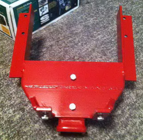

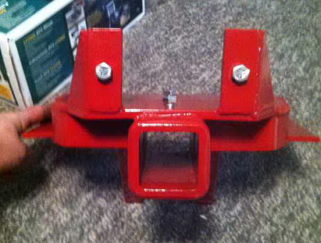

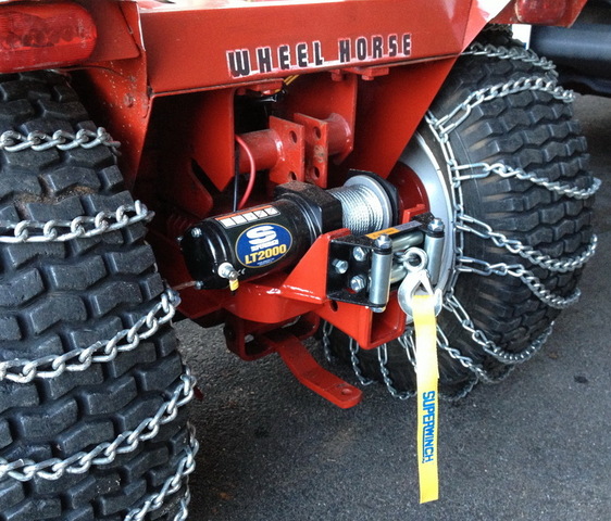

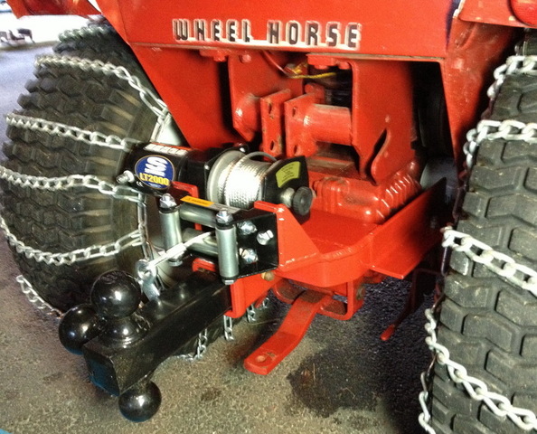

JamesBe1 84 #76 Posted April 1, 2013 Here ya go boy's! A "Custom" custom hitch! I had scot add a mounting plate for a 2000lb winch (Superwinch 2000LT). Came out absolutely awesome, and works great, very functional. I can now use a 2" hitch receiver or any other 2" receiver attachment, I can use the winch to pull wood trees and logs out of the woods, and I still also can use the garden hitch below to pull a tractor cart.... Looks and fits factory made. Scott was a pleasure to work with. Now that's outstanding! Scott, if you are making any more of them, I might be interested. Share this post Link to post Share on other sites
Machria 90 #77 Posted April 1, 2013 He said he would save the dimensions so he could duplicate it.... I had dropped shipped the winch to him, so he could make sure it fit and let me tell you, it fits PERFECT. Used it yesterday to pull a huge 25" tree about 15' long out of the woods. I could not get the tractor all the way to it, and the tree was surrounded in heavy brush I didn't want to spend all day clearing just to get the log out. So I wrapped a rope around the log, connected the winch and winched it right out of the woods. That one tree was worth the entire project cost! Share this post Link to post Share on other sites

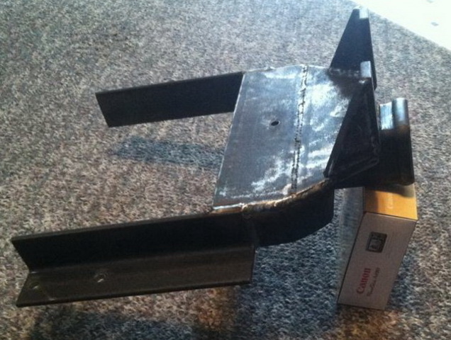

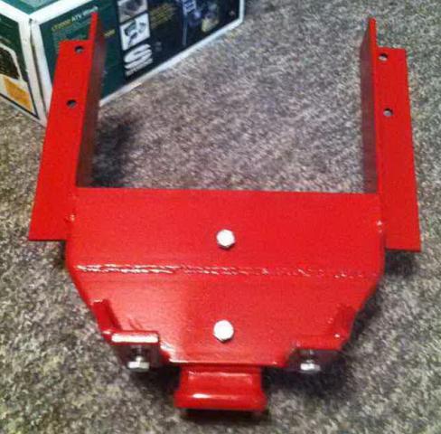

Machria 90 #78 Posted April 1, 2013 A few more pics for you, unfinished, painted, installed without the winch, then completed: PS- Got the winch at NorthernTool.com on sale/clearance for $54 (fifty four). Killer deal. 2 Share this post Link to post Share on other sites

Machria 90 #86 Posted May 9, 2013 Machria, Now you need to make a part to go into the receiver that will reverse the cable on a large pulley with guides to reverse the line out the front of the tractor for pulling from either end. That's a great idea, and easy to do really. One thing I have found with the winch is, you can't pull much weight because it pulls the tractor instead of the object! You have to put the tractor in gear very slowly to hold it in place, as you crank in the winch.... Share this post Link to post Share on other sites

Stormin 9,988 #90 Posted July 2, 2013 Machria, Now you need to make a part to go into the receiver that will reverse the cable on a large pulley with guides to reverse the line out the front of the tractor for pulling from either end. That's a great idea, and easy to do really. One thing I have found with the winch is, you can't pull much weight because it pulls the tractor instead of the object! You have to put the tractor in gear very slowly to hold it in place, as you crank in the winch.... Chock the wheels or use a ground anchor. Share this post Link to post Share on other sites
