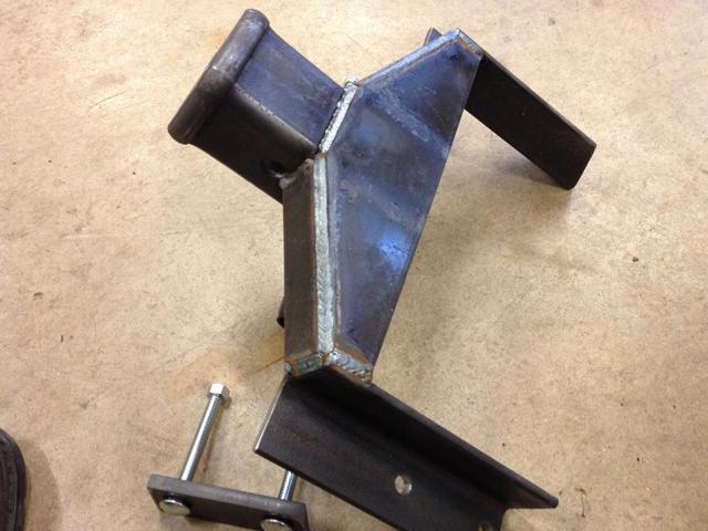

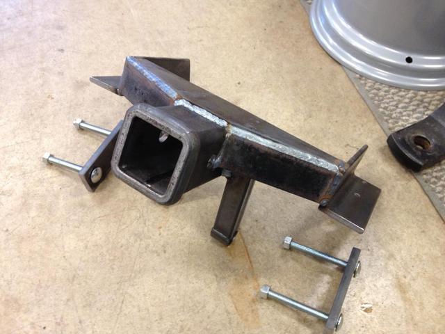

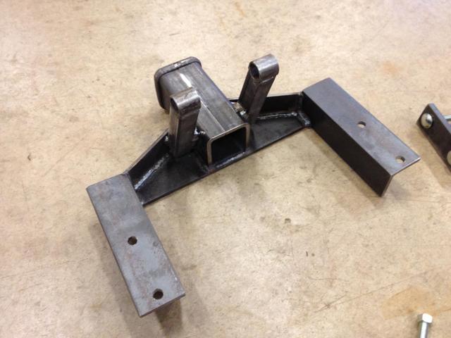

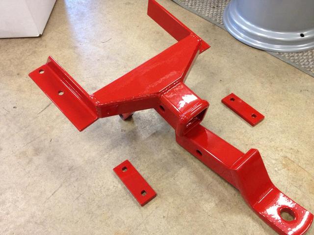

smoreau 658 #26 Posted January 21, 2013 (edited) We got 11 hitches built so far. Its been a busy Sat and know I have a sick little girl So I haven't got all I wanted to get done this weekend. I didn't get the extra plates drilled like I wanted and Tom is still working on the square hole thing. Trying to get them made without spending $130 on a broach. I plan on getting them cleaned up and ready to paint in the next day or so. Here is a pic of the hitches We had some help with the welding this time around, Tyler witch is Toms son is taking welding classes at his high school and we decided that it was time to put him to work! And what a pic that Tom took of me that I thought was cool looking If all goes well this week and Gabby is feeling better, I should have all the hitches that were ordered without the extra plates shipped out next Sat. Also we will build the rest of the hitches, XI hitch, and the tiller hitch next Sat also. 16 sold and I have room for 6 more without getting any more material If needed I will buy more. Edited January 21, 2013 by smoreau 2 Share this post Link to post Share on other sites

smoreau 658 #32 Posted January 23, 2013 Ok it's official! I do not like this Rust-oleum Regal red paint!! I tried it out on two hitches and the color looks Great! but it runs very easy. And don't try and put a second cote on it 24 hours later! Lifted and looks very bad! I new all of this, but I have been so use to the valvspar paint that didn't do this. so I had all the hitches painted tonight and the two that I had put a second cote will now need to be put in a solvent tank to get all the wrinkled paint off. So I put a light second cote on the rest of the hitches while they were still tacky and they should be fine. I guess I just want to make more work for my self :banghead: 1 Share this post Link to post Share on other sites

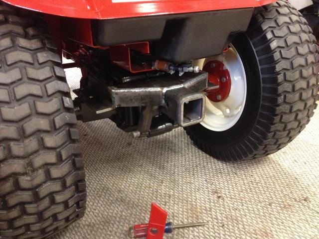

smoreau 658 #33 Posted January 27, 2013 All hitches that were ordered so far are built. They are in my work shop warming up to get there first cote of primer latter today. Extra plates are now made with square holes in them and will work much better then before. Tom made a punch set up that goes in the press that cuts the corners out of a 3/8 round hole. It is time consuming job, but looks and works much better then before and worth the extra effort. Tiller hitch and XI hitch are also made and the XI hitch was test fitted and looks good. Dimensions are now saved in a safe spot. All hitches will be mailed out by next Sat. the 2nd of Feb. Some picks of the XI and the tiller hitch. And the tiller hitch, it is 2" shorter. I did not get the chance to check this hitch out on the tractor as I didn't have a tractor over to toms with a tiller dozer blade mount on it. I will try to get it mounted latter this week and try it out. the extra plates Share this post Link to post Share on other sites

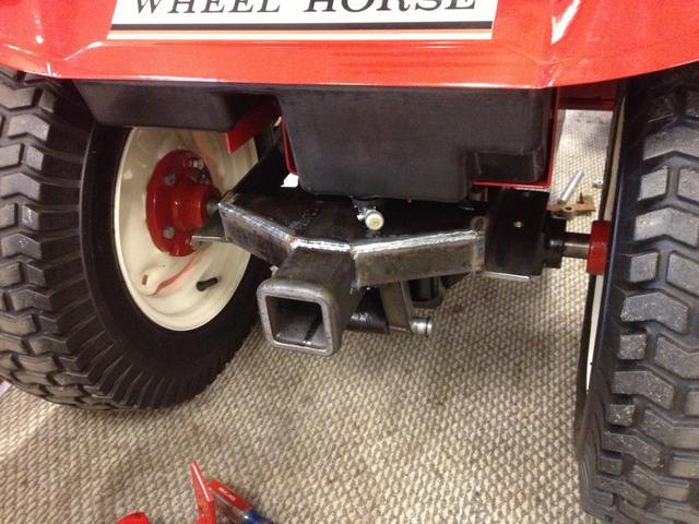

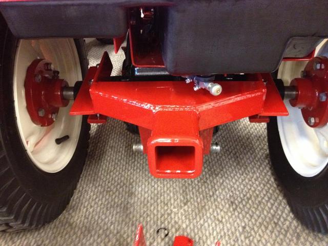

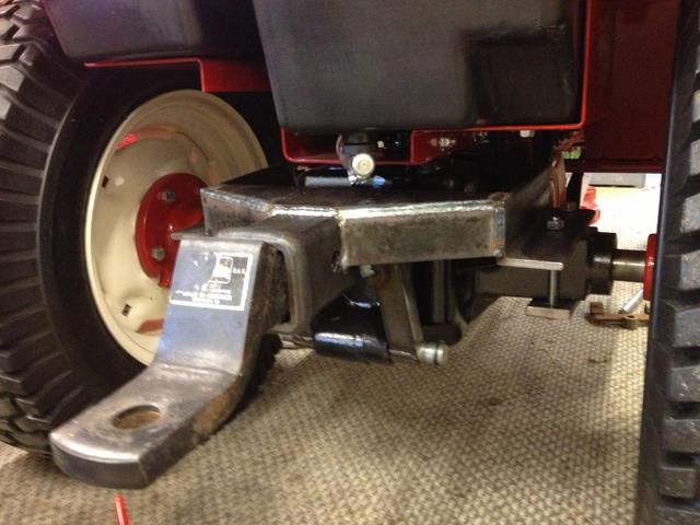

Martin 2,133 #44 Posted February 7, 2013 yes, i second that.... thank you very much, mate...... wow, great piece scott! very impressed with the workmanship...... i got mine today and test fitted it on the c125. eventually it may go on the gt1848, but i was curious to see how it looked mounted up....... heres some pics. all ready for some powdercoat ih red after a good blast and wash........ Share this post Link to post Share on other sites
scWHhauler 96 #45 Posted February 8, 2013 Got both of my on wed this, will be a great addition to my dads 141 restore and my GT 2500. GREAT workmanship great design.The GT2500 is all ready mounted and pulled my utility trailer form the backyard to the driveway I will send some pictures this weekend.THANKS Share this post Link to post Share on other sites
Martin 2,133 #46 Posted February 8, 2013 all painted up. looks great on the tractor, thanks again scott!!!! 1 Share this post Link to post Share on other sites

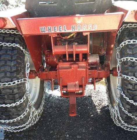

Machria 78 #50 Posted February 14, 2013 Can you make one for the GT14? Pic of my ass end........ Thanks.... Share this post Link to post Share on other sites
