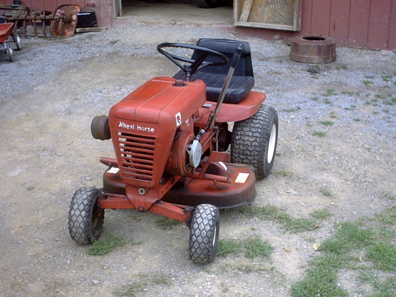

TT
I actually prefer the early axle and steering set up (pre '64 on the Rangers?) as opposed to the later axle.
'62 & '63 used the non-cambered axle with the solid tie rod and short drag link.
1962:
1963:
1964 had the same axle as the 1964 round hood tractors and had individual tie rods connected to cast arms pinned to the spindle tops.
1965 - 1968 used the narrower Lawn Ranger-specific front axle with two tie rods connected to arms welded to the spindle below the front axle.
