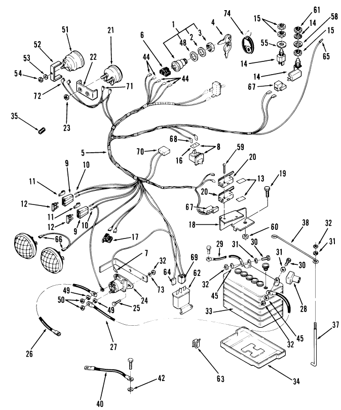

Sparky-(Admin) 25,304 #4 Posted December 30, 2012 I'm pretty sure the switch is under the drive belt guard. There is an idler pulley for tension on the hydro drive belt and the pullet has a tab which pushes a switch. I think you can access the wiring for the switch by removing the metal plate (where the manual shift lever would be if your tractor was an 8 speed). Its #8 on this diagram, unfortunatley it does not show a location. Mike........... Share this post Link to post Share on other sites
