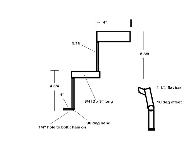

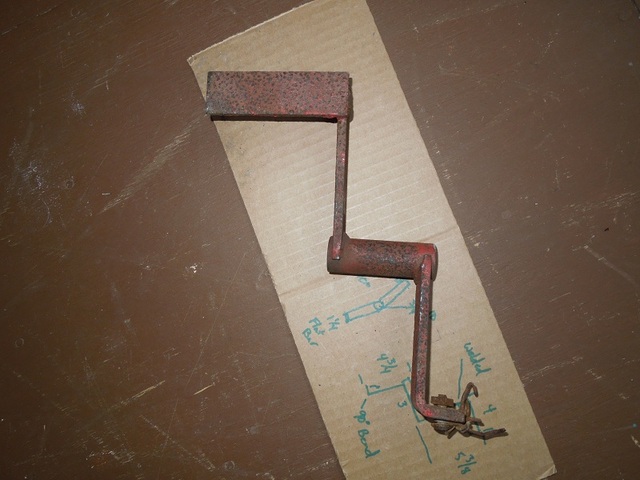

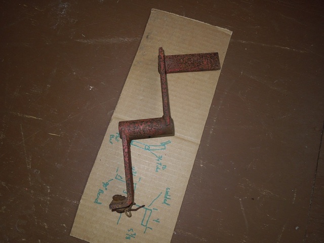

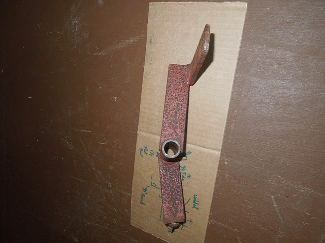

wallfish 20,088 #30 Posted January 4, 2013 recoil should be red Here's the pics and measurements for the dozer foot pedal Share this post Link to post Share on other sites

wallfish 20,088 #32 Posted January 4, 2013 From post #18 of this thread Just a note for you. The factory set up for the dozer blade used a foot pedal that connects to the pin with a small chain to pull it when angling the blade. A small rope like clothes line is used that hooks to each top corner of the blade with S hooks and drapes around the steering wheel. Push the pedal to release the pin and use the rope to pull the blade for changing the angle from the seat. Share this post Link to post Share on other sites

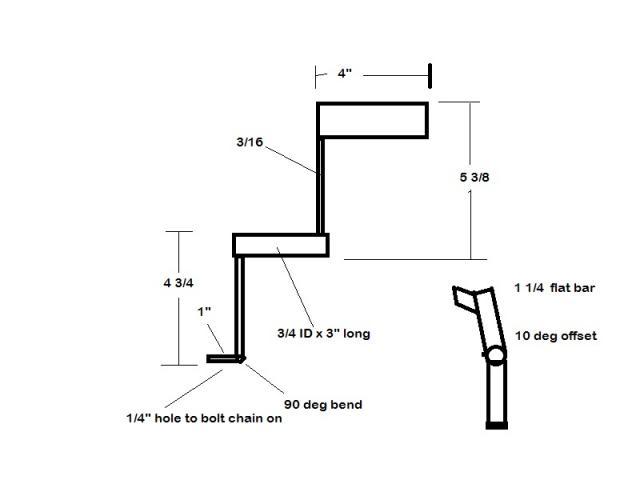

hcminis 1,787 #34 Posted January 4, 2013 Was looking through photos of the 401 I'm restoring. Found this picture and remember now that I couldn't figure out what this pedal was for. Now just need to find what I did with it. Share this post Link to post Share on other sites
wallfish 20,088 #35 Posted January 4, 2013 Yup, that's it. They always seem to be missing like the belt guards but at least they are fairly easy to reproduce Share this post Link to post Share on other sites
