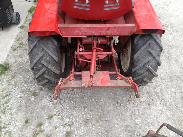

Brrly1 1,146 #41 Posted February 15, 2013 Nice tractors guys!! GT14 are the best! Favorite tractor! The bars that are flat stock are Not stock. I've posted a picture of my GT14 loader backside. I would guess someone has improvised to make it work. Good Luck to both of you. 1 Share this post Link to post Share on other sites
