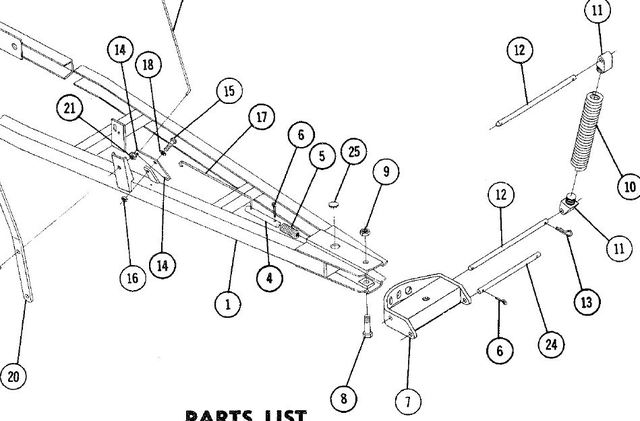

Mykol610 2 #4 Posted December 28, 2012 I just noticed there's a cotter pin that should go through it. It sheared off both sides. I'm gonna have a friend help me get it replaced but one other question... How easy does the spring come out? Is it locked in any which way? I'll need a new cotter pin definately but would like to know if I should get a new spring while I'm at it. Share this post Link to post Share on other sites
SousaKerry 503 #5 Posted December 28, 2012 (edited) I've actually never had one break, but I'm sure it does happen Link to manual Edited December 28, 2012 by Sousakerry2 Share this post Link to post Share on other sites
Mykol610 2 #6 Posted December 28, 2012 I see what your showing... Per the picture... 4 has fallen out. 6 is sheared off both sides of 4. What my last question was how is 5 held in? Without the pin (4) pressing onto it, is it likely to fall off and possible get lost? Or is it hooked on another piece? Share this post Link to post Share on other sites
SousaKerry 503 #7 Posted December 28, 2012 (edited) Good question I'll have to look at one I think that the hole covered by part #25 is where the roll pin is inserted into the #4 pin, could be that the spring is actually supposed to be on the other side of the tongue, and the drawing is misleading. I'm sure some one else will chime in here that has had one apart before, Edited December 28, 2012 by Sousakerry2 Share this post Link to post Share on other sites
RCTruckDaddy 8 #8 Posted December 29, 2012 The spring is inside the tongue. The pin goes in from the rear thru the spring. Then looking thru 3/4" hole in top of tongue you put cotter pin thru the hole in item 4 to preload the spring. I did this to mine when I restored it. Share this post Link to post Share on other sites
