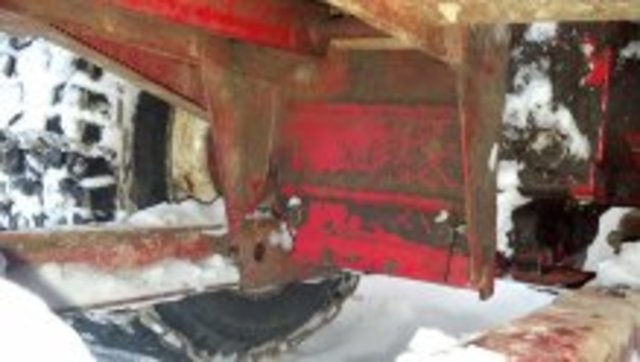

can whlvr 994 #10 Posted December 29, 2012 ive had to shim the ball towards the cam,but you say its too tight,definatly look at the mounting plate and frame for bending or cracks Share this post Link to post Share on other sites
sorekiwi 761 #12 Posted December 31, 2012 Got a welder? Share this post Link to post Share on other sites
