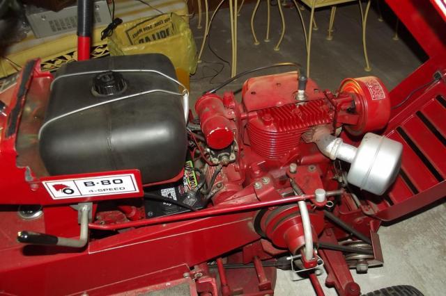

Kevbo 81 #1 Posted December 27, 2012 So if you could put a new exhaust on this C-81, what would you change and how? Share this post Link to post Share on other sites
glgrumpy 35 #2 Posted December 27, 2012 Loosen up some of pipe fittings to retighten OR buy new and have point UP! add a pipe or small tractor muffler for Stack! Add flapper! Or, if NOT, loose the same fittings or buy new and tighten to point down and at slight front angle, but closer to engine and add same or new muffer down lower. Yours looks like someone just added a length at top to move out from hood. Stock is kinda partly under hood, but pointing down (forward) at angle. DON'T try to overtighten these old fittings, you may break he cylinder casting. Hold the part comeing just outside of engine port with one pipe wrench and loosen the coupler and rest with another pipe. Use new parts to best select the angle and keep it tight. 1 Share this post Link to post Share on other sites
Ken B 3,203 #3 Posted December 27, 2012 It looks like a nice tractor, I'd ditch what you have and try too find a nice factory muffler for it. I do like custom exhaust pipes but I think the factory setup would look best on yours. 2 Share this post Link to post Share on other sites

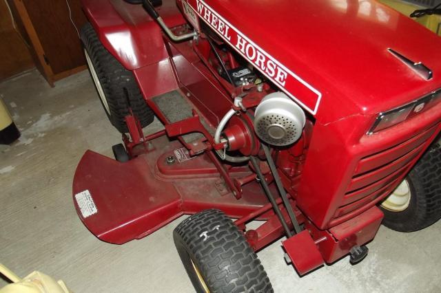

BOWTIE 226 #8 Posted December 28, 2012 THIS IS WHAT I HAVE ON MY 75 B80 IT IS SIMPLE AND DOES NOT BURN THE PAINT. THIS MUFFLER IS GOOD FOR 8 HP OR LESS. BOWTIE IN OHIO Share this post Link to post Share on other sites

Ken B 3,203 #10 Posted December 28, 2012 Here is another idea. This is the muffler setup I put on a Charger 12 I restored a few yrs. ago. I never smelled when I got off this tractor. The muffler was off a Cub Cadet 122. I agree with Kelly, a stack setup can look good if done right, most times they aren't though. 6 Share this post Link to post Share on other sites
