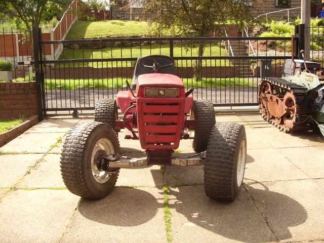

DIBNAH 17 #1 Posted December 27, 2012 Meet Widestride. Modified C120 for logging work over rough terrain. Agri tyres to go on and independant rear brakes. Holds its course on steep banks and steers good. Very stable tractor, pulls a 4x5 4 wheel trailer and soon to be log skidder. Deciding whether to put rubber fenders on all round or leave it as it is. When all mods have been made i will tear it down for paint. Can anyone recommend a reliable 12volt winch for the front. 9 Share this post Link to post Share on other sites

Stigian 1,235 #7 Posted December 27, 2012 That's a cool machine, look forward to seeing the vids of it in action. How did you widen the rear track? Share this post Link to post Share on other sites
meadowfield 2,955 #8 Posted December 27, 2012 Ian, I reckon he used your method of extended rear hubs :) Share this post Link to post Share on other sites
AMC RULES 37,254 #9 Posted December 27, 2012 I remember him posting some of the "Widestride" build picts in the gallery last week. Share this post Link to post Share on other sites
Stigian 1,235 #10 Posted December 27, 2012 Ian, I reckon he used your method of extended rear hubs I reckon your right Richard I remember him posting some of the "Widestride" build picts in the gallery last week. Thanks for that Craig. I've just had a looksie through Dibnah's gallery pic's.. Dibnah..... Your my kind of engineer :thumbs: Share this post Link to post Share on other sites
DIBNAH 17 #11 Posted December 27, 2012 Hello Stigian, Meadowfield, Dual, Yes, much the same as Stigians but if you make the keyway cutter in a pair only half the width of the keyway ie one top and one bottom cutter you can take deeper cuts in one pass and this speed things up, dress keyway with fullsize cutter and your done. As Stigian knows its real enjoyable part of the job!. Resizing photos for these forums so you can see the full build. The rear hubs are a press fit to the shaft and welded, the hubs are built in rear weights. Share this post Link to post Share on other sites

JC 1965 1,544 #15 Posted December 28, 2012 I don't understand how you extended the rear wheels out like that and can't tell by the picture how you have the front end set up. also, what size wheels and tires do you have front and rear ? I would like to see more pics becauce I really like the look. I have an old Raider 12 that I've been wanting to do something with and this looks very interesting. Great Job !! :notworthy: Share this post Link to post Share on other sites
DIBNAH 17 #16 Posted December 28, 2012 Thanks, I will put on full build pics as soon as I can and will be more than happy to explain them, getting jammed up with private messages and emails about this so you will have to bear with me, go to my album for more pics Regards Dibnah. :) Share this post Link to post Share on other sites

312Hydro 474 #20 Posted December 29, 2012 Just found your build. That's some original thinking! I like the wide front axle and will also be watching your build. great work! Did you make the knuckles too? :handgestures-thumbupright: Share this post Link to post Share on other sites
DIBNAH 17 #21 Posted December 29, 2012 Hi Hydro, followed a few of your post too, yes all parts were made in my workshop and as i post build pics you will see that the work is not that special- you just need the tools to do it. If a pic doesnt make sense to you email me. regards Dibnah. 1 Share this post Link to post Share on other sites
