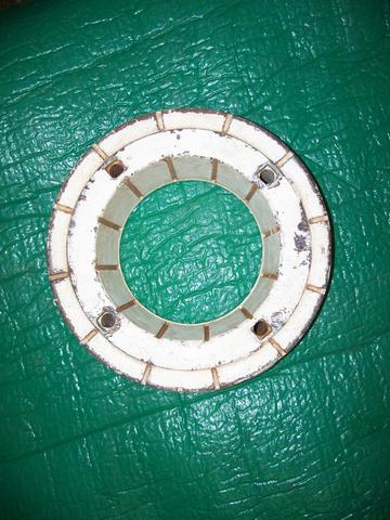

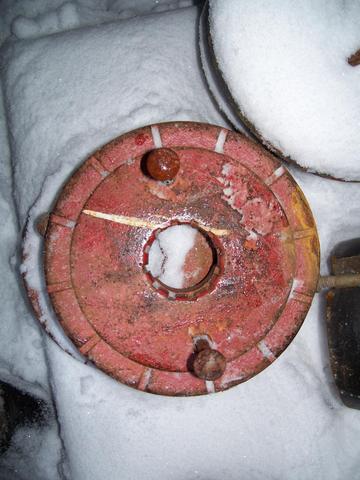

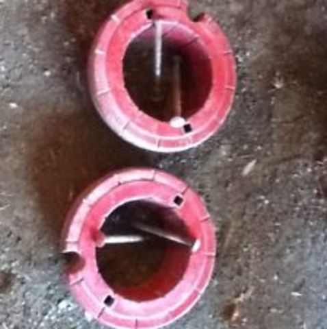

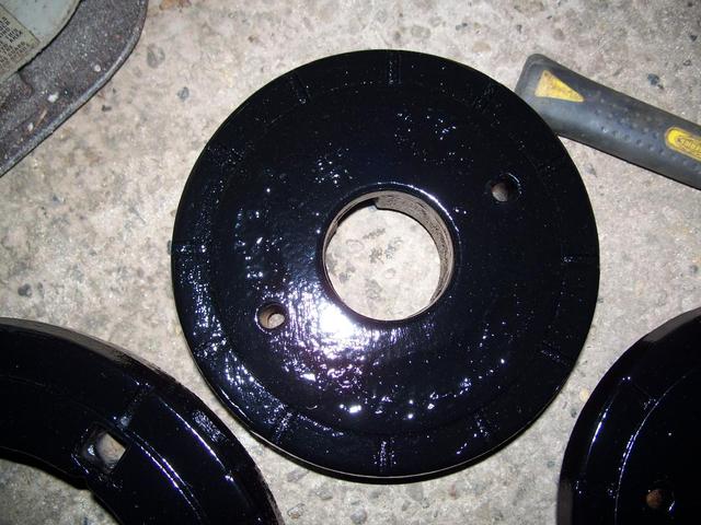

Kelly 1,036 #1 Posted December 27, 2012 I have a few sets of WH cast iron weights, and have sold a few sets, I'm trying to figure out a few things on the differences in them, there are two styles of rears and fronts, the first one up is the rear weights, this I know is a factory WH weight, 4 mounting holes and a full circle. This is another set, like the factory weights, but with a few differences, only one set of mounting holes and a notch for a valve stem, I've had a few sets like this and came on WH tractors, but I know Gravely tractors also use this style weight. now the fronts I have both style weights and just a few weeks ago figured out the one set will fit my 520 with the forward swept axle as the rims have a bigger center hub, this one the center hole is smaller and has the groves in the center hole to match the outer ring, again I know Gravely used this style weight for the fronts as well as the rears. This style has the bigger center hole and no groves, this one will fit the 520 with swept axles. Question is rears, are the ones with valve stem notches real WH, or just the vendor that made them, set them up to be used on more brands?? and at what point did they start doing this? I'm guessing mid 70's going by tractors that I have got them off. same for the fronts when did they start putting the larger hole with out the groves?? and are these just a change the vendor did to fit more brands? I'm pretty sure WH did not make their own weights, they bought them from a vendor, same with many other parts on these tractors, WH just told them what they wanted. Share this post Link to post Share on other sites

Sparky-(Admin) 24,119 #4 Posted December 28, 2012 I think you nailed it with the statement that WH didnt make these weight but had them made by a vendor to WH specs. The vendor must have made them for a few other tractor companies and folowed their specs. Mike......... Share this post Link to post Share on other sites

Rollerman 290 #6 Posted December 29, 2012 Kelly I was told the rear weights with the valve stem notches were ment for D's? 1 Share this post Link to post Share on other sites
Kelly 1,036 #7 Posted December 29, 2012 So are the 12" wheels on the D's valve stems on the outside? the D's I've had have all had 15" wheels Share this post Link to post Share on other sites
Trouty56 567 #8 Posted December 29, 2012 Mine are Kelly. Sent from my phone........ Share this post Link to post Share on other sites
Kelly 1,036 #9 Posted December 29, 2012 Thanks guys this is the info I wanted, and maybe inform others as well. Share this post Link to post Share on other sites
855ownerJoel 32 #10 Posted December 30, 2012 I think you are right Kelly, just like Carlisle (Used to make rims in Slinger) makes rims for numerous companys, so are a lot of other products built by one company to be sold to other companies for their equipment. Depending on what year and who they bought parts from probably determined what style or look was sold as an aftermarket product through Wheel Horse for their tractors. Share this post Link to post Share on other sites
